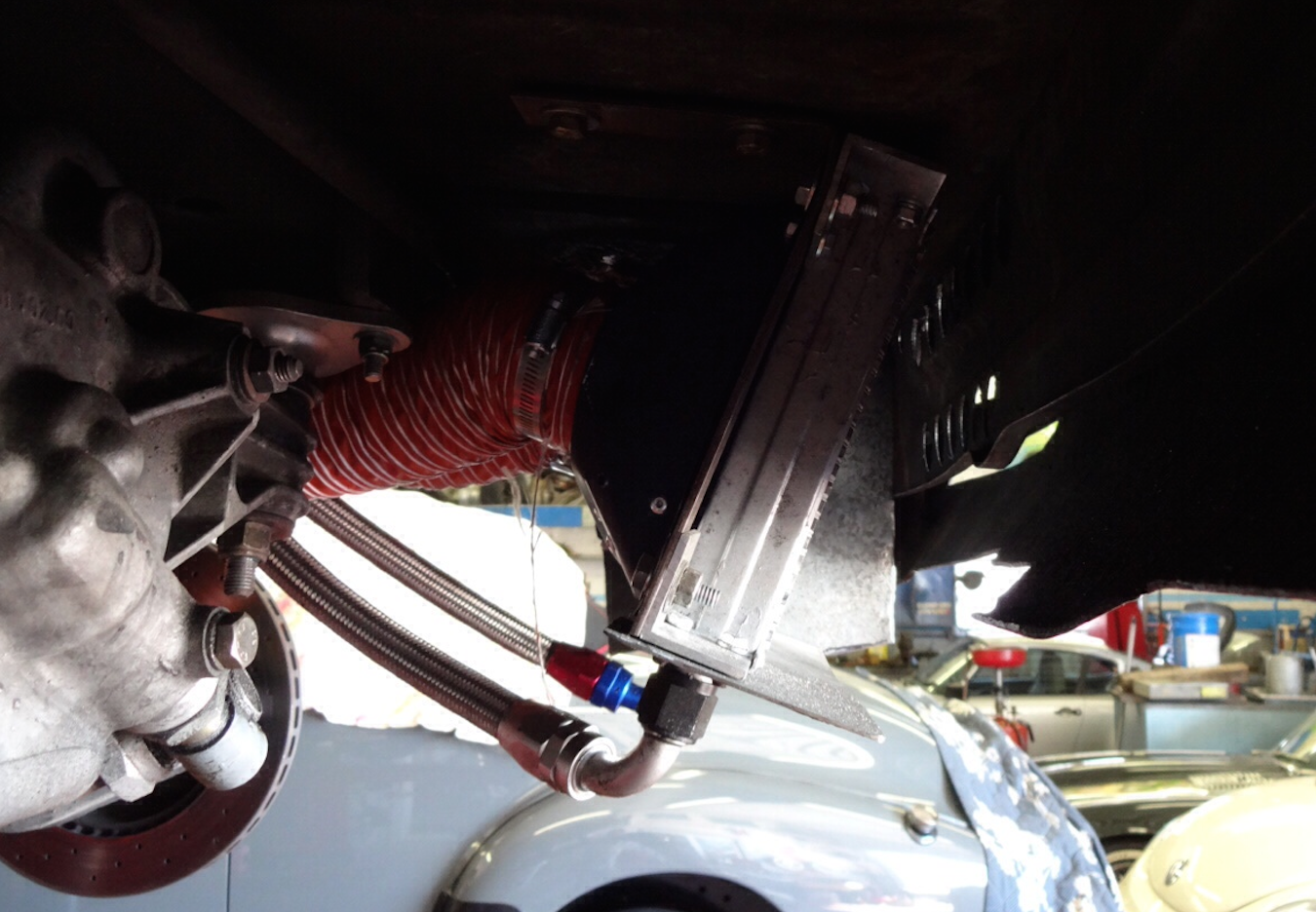

Jetsetsurfshop   Duct work   May 27 2014, 09:35 AM
veekry9   Duct work Remarkably similar to the P51 belly s...   May 27 2014, 08:35 PM
Jetsetsurfshop   Tubing   May 27 2014, 09:36 AM
Jetsetsurfshop   To the cooler. There is also a air duct on the low...   May 27 2014, 09:38 AM
Racer Chris   What does the inlet side of the cooler look like?   May 27 2014, 10:15 AM
Jetsetsurfshop   Here you go Chris. Screens are not installed yet i...   May 27 2014, 10:26 AM
Racer Chris   I meant where the ducts end at the face of the coo...   May 27 2014, 10:39 AM
Jetsetsurfshop   I meant where the ducts end at the face of the co...   May 27 2014, 10:58 AM
brant   nice work.... I built something similar for my tr...   May 27 2014, 11:05 AM
Jetsetsurfshop   nice work.... I built something similar for my t...   May 27 2014, 11:23 AM
brant   I think your lack of the 90 turn is only going to ...   May 27 2014, 12:01 PM
Seabird   I was under the impression that the tumbling air u...   May 28 2014, 07:51 AM
Jetsetsurfshop   I was under the impression that the tumbling air ...   May 28 2014, 09:40 AM
Seabird   I was under the impression that the tumbling air...   May 28 2014, 09:41 AM
brant   you have a great bunch of teeners out there... tim...   May 28 2014, 10:26 AM
Jetsetsurfshop   New bumper exit. I think I've been building up...   Jun 15 2014, 09:02 AM
ablesnead   Shane that screening reduces airflow about 30 perc...   Jun 15 2014, 09:26 AM
Jetsetsurfshop   Shane that screening reduces airflow about 30 per...   Jun 15 2014, 09:34 AM
Jetsetsurfshop   Took the screen off and added brackets to hold the...   Jun 15 2014, 11:18 AM
Seabird   Took the screen off and added brackets to hold th...   Jun 15 2014, 05:30 PM
Jetsetsurfshop   Took the screen off and added brackets to hold t...   Jun 15 2014, 05:56 PM
Seabird   Cool, I am going to try and bring mine too. Oil, ...   Jun 15 2014, 06:12 PM
