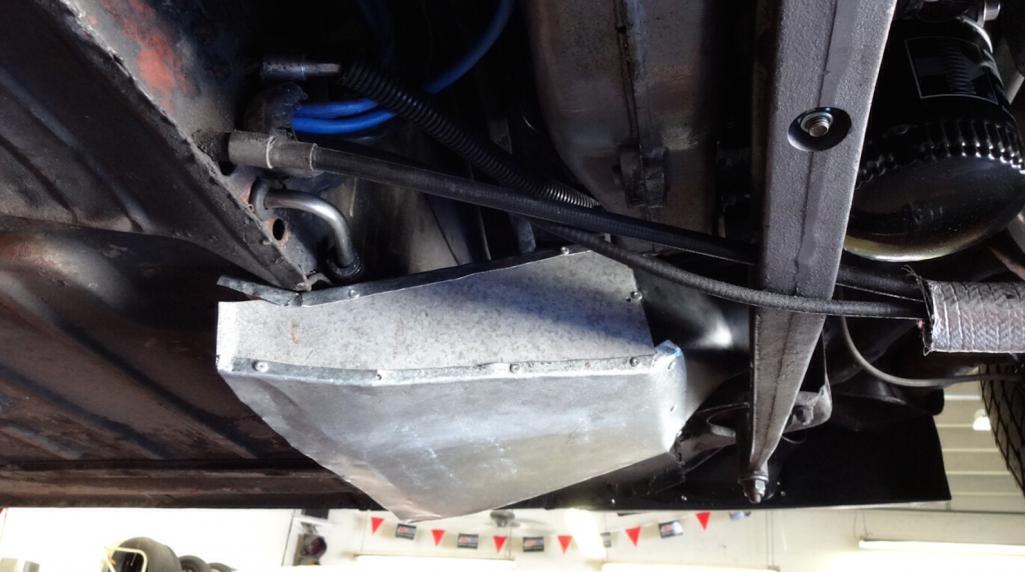

Hey Everyone (IMG:style_emoticons/default/biggrin.gif)
Here's what I'm running
2258cc
10.5 to 1 compression
40 webers
494 web cam
type 1 oil pump
mocal oil cooler 25 row
mocal sandwich w/thermostat adapter
accusump 2 quart
Brad Penn Air-cooled oil 15-50 (5 1/2 quarts)
Let me explain my set-up
The oil cooler is a rear mount under the car on the passenger side rear. I made some duct work and its almost vertical to catch the most air as possible.
Track conditions
Sunny, low 80s, 30min sessions
question 1) With that cooler I didn't expect to run in the 230f oil temps. Is 230f acceptable?
question 2) I also have some oil on the top of the case /engine tin pooling. 1-2 side.
It only happens under WOT. Any ideas?
question 3) I never set-up an accusump and I don't like it so far.
It over fills the case at shut-off. Do I have to much air in it (9lbs)?
Other then my oil questions, I had a great time. Ran a 2:51. My new best time.

Duct work
veekry9
post May 27 2014, 08:35 PM
OldMember
Group: Retired Members
Posts: 3,068
Joined: 17-June 13
From: TO
Member No.: 16,025
QUOTE(Jetsetsurfshop @ May 27 2014, 11:35 AM) *
Duct work
Remarkably similar to the P51 belly scoop.
It worked because of what followed,a low pressure area.
A RR Merlin had to dissipate a lot of heat,and the solution was low drag.

Jetsetsurfshop   Duct work   May 27 2014, 09:35 AM
veekry9   Duct work Remarkably similar to the P51 belly s...   May 27 2014, 08:35 PM
Jetsetsurfshop   Tubing   May 27 2014, 09:36 AM
Jetsetsurfshop   To the cooler. There is also a air duct on the low...   May 27 2014, 09:38 AM
Racer Chris   What does the inlet side of the cooler look like?   May 27 2014, 10:15 AM
Jetsetsurfshop   Here you go Chris. Screens are not installed yet i...   May 27 2014, 10:26 AM
Racer Chris   I meant where the ducts end at the face of the coo...   May 27 2014, 10:39 AM
Jetsetsurfshop   I meant where the ducts end at the face of the co...   May 27 2014, 10:58 AM
brant   nice work.... I built something similar for my tr...   May 27 2014, 11:05 AM
Jetsetsurfshop   nice work.... I built something similar for my t...   May 27 2014, 11:23 AM
brant   I think your lack of the 90 turn is only going to ...   May 27 2014, 12:01 PM
