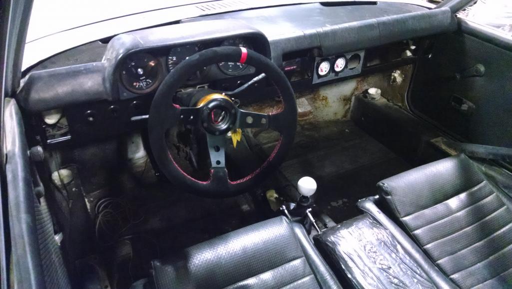

Thought about it maybe later down the road. I am just going to run them out the back or sides. Also got some new stuff in
-autometer phantom guages water temp/oil pressure
-momo steering wheel adaptor
-universal quick release
-universal black shade steering wheel
-used track 914 roll cage
-stinger ecu hooked up
-Water and fuel lines done

Porscharu73   Bought a 91 celica shifter from a pick and pull ju...   May 13 2014, 11:37 PM
Porscharu73   feels like a short shifter   May 13 2014, 11:41 PM
Porscharu73   shifter fabricated and cables bought from a sho...   May 13 2014, 11:49 PM
Porscharu73   Shift knob that was order off ebay also order the ...   May 13 2014, 11:54 PM
Porscharu73   I am very happy how it came out looking   May 13 2014, 11:57 PM
