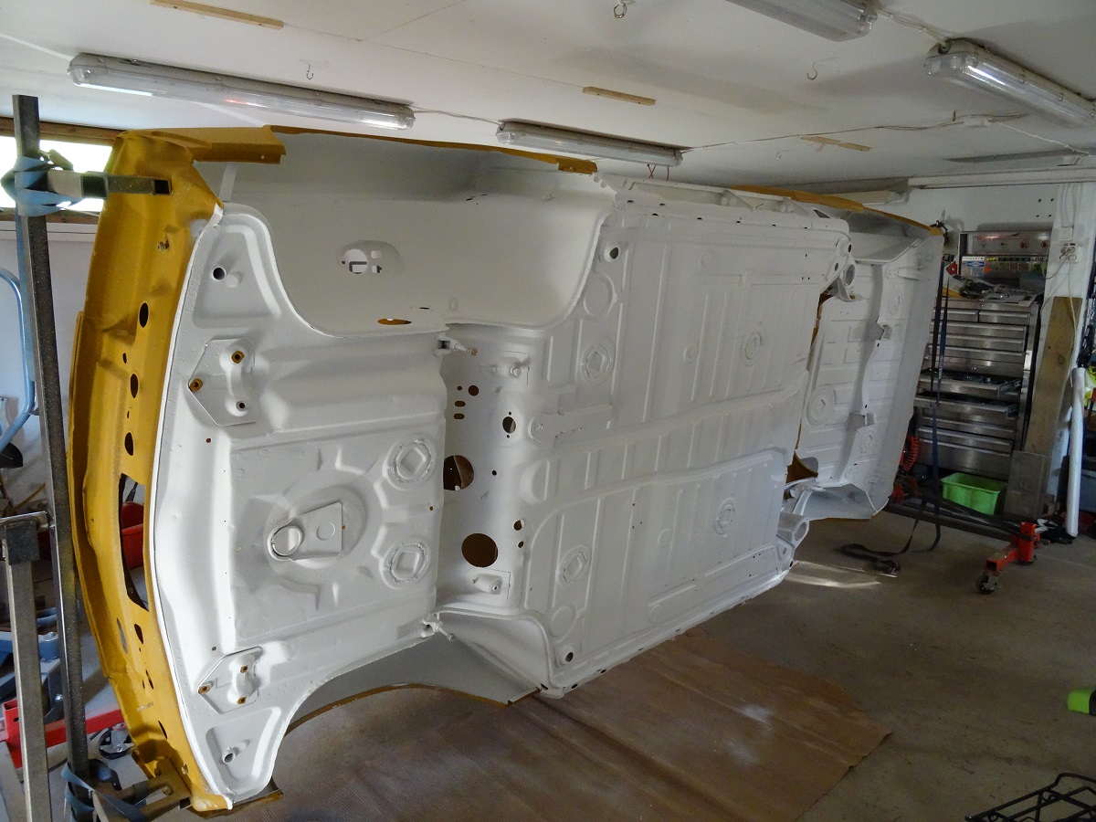

post May 30 2014, 12:15 AM
Posts: 1,579
Joined: 22-November 12
From: Sweden
Member No.: 15,176
(IMG:http://www.914world.com/bbs2/uploads_offsite/matsgarage.com-15176-1401432026.1.jpg)
Undercoat went on yesterday, car will be white again but with a more modern white than the Light Ivory original colour.
Edit: pic was way to big, no sure why it didnt resize....
