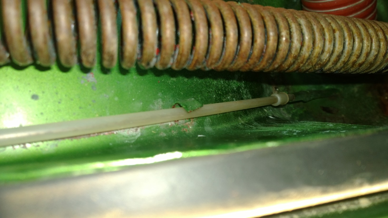

This is for the front trunk cable along with the guide tube. I found that mine was cracked and didn't allow the cable to pull effectively, so here you go. These will be ready next week.

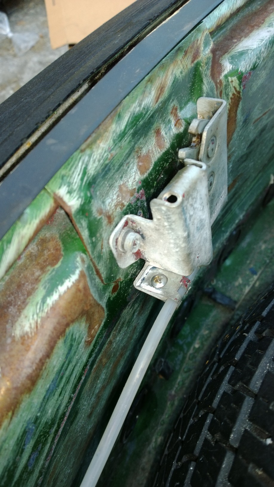

Remove the old tube and thread the new one up from the bottom. That way it can go throught the hole under the bucket.
Thread the new wire in, and into the new guide tube, snug it onto the tube in the body. Screw in the handle and push in.
Then thread the wire through and tighten the screw at the mechanism, and screw the tube down.
DO make sure you have the tube running through the tabs and you are done. The action will be much tighter.
