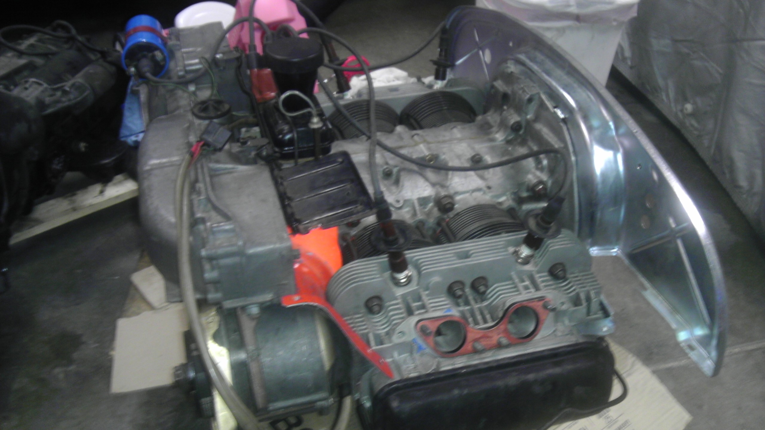

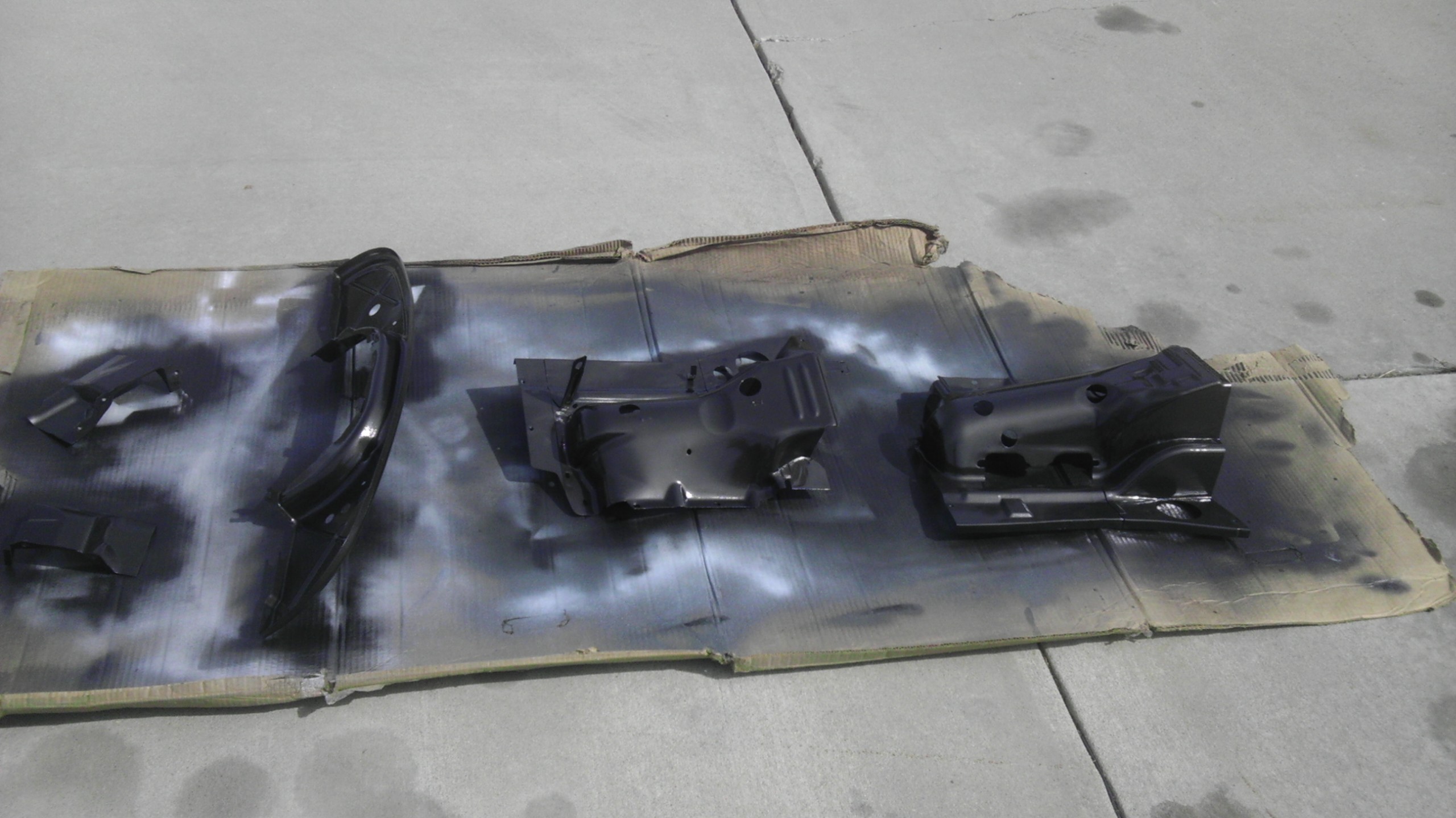

Figured I would get off my lazy butt and post this as I told you guys I would, new motor has been in for a couple months now.

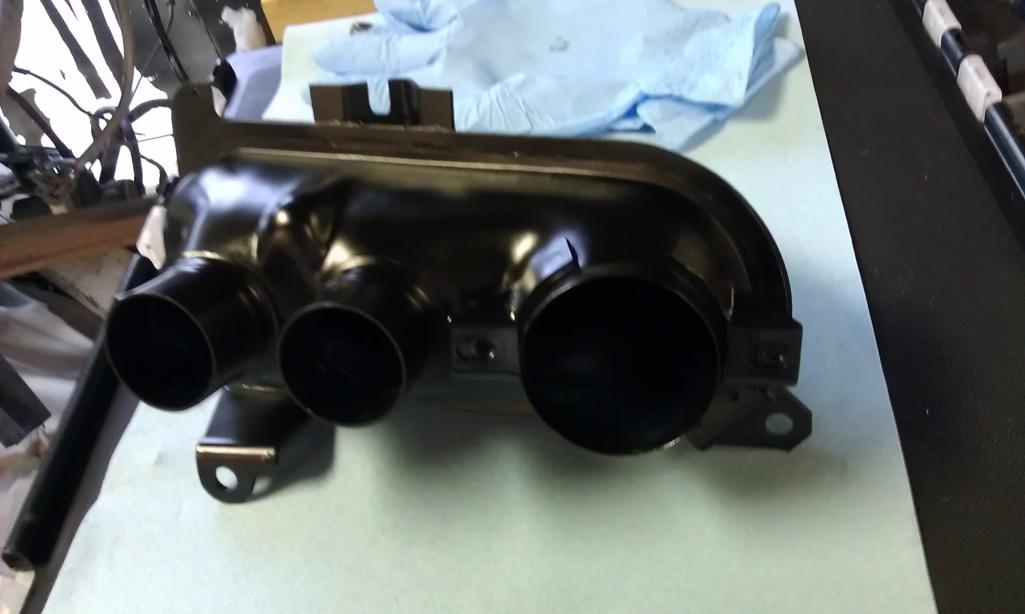

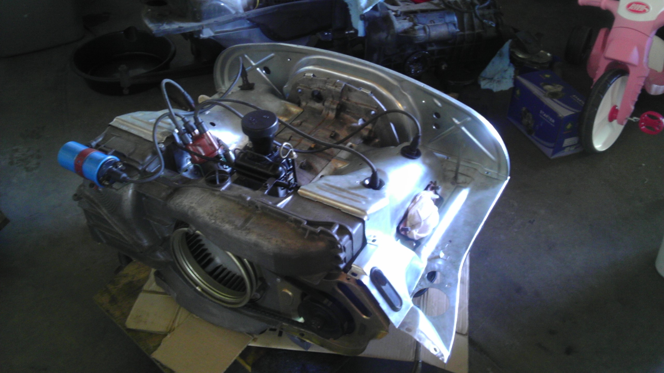

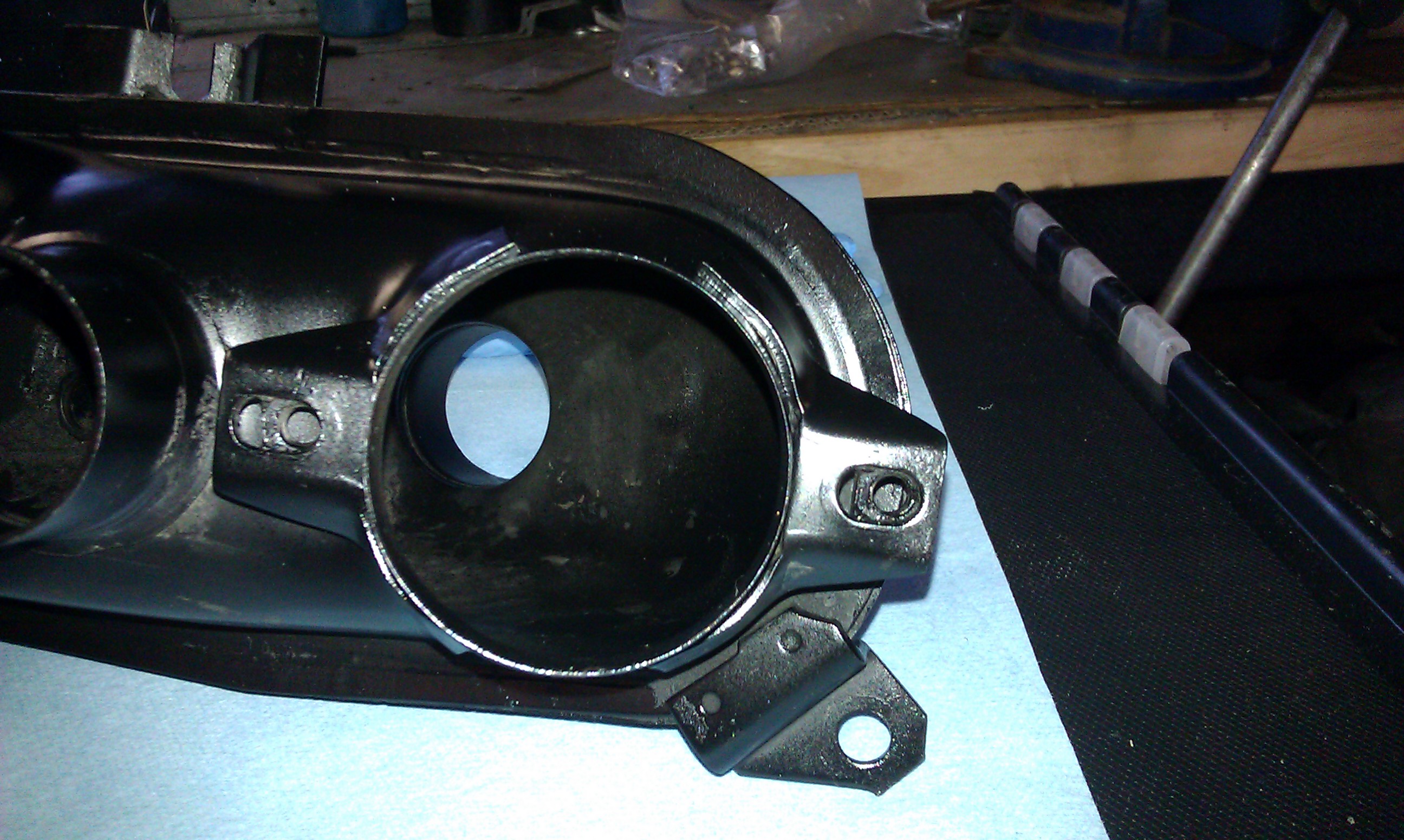

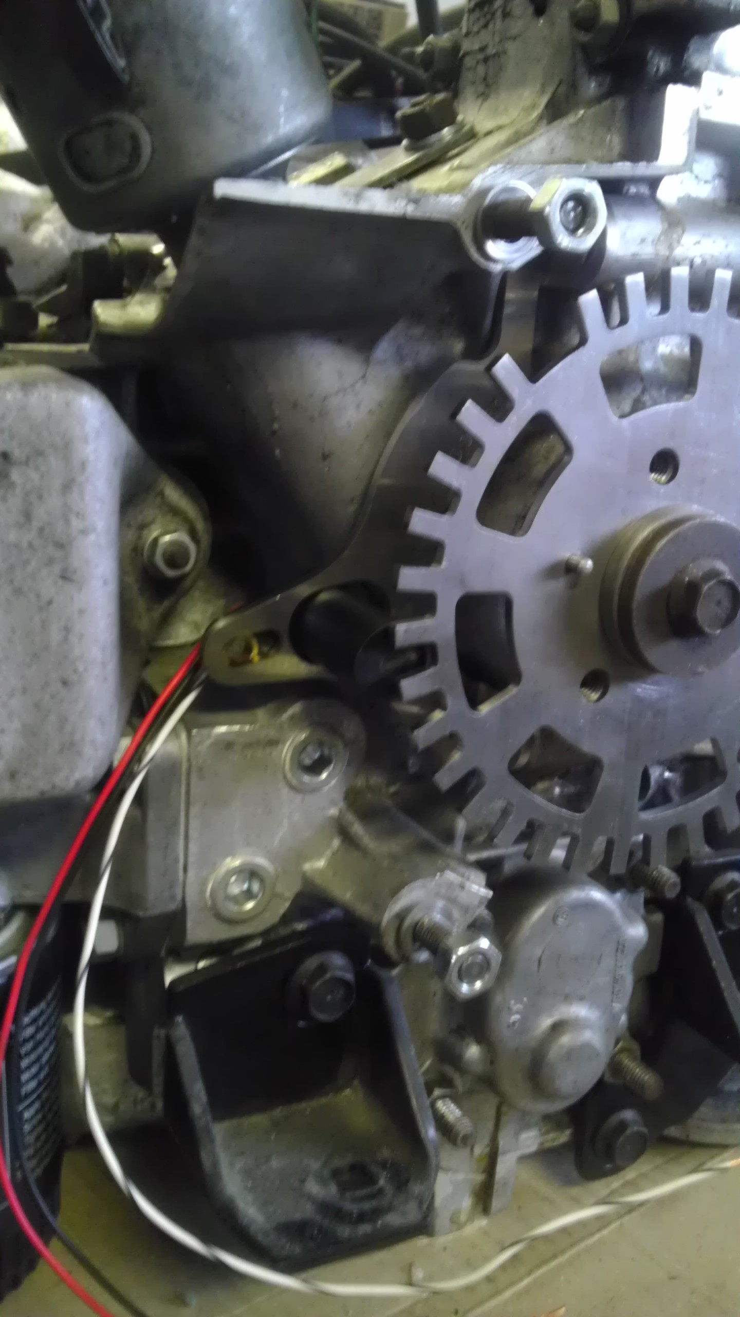

Guess we will start with how it came to me: needed to "make it mine" though so, here we go shinny tin is neat but think I want it to look a bit more stock (yes Eric I repainted the hidden orange piece) Should have sanded the plating down a bit, even with bare metal primer it chips easier then I would like Tin is off, good time to install Marios trigger wheel setup some more tweaks, opened up a 1.8 plenum to 52mm, used with a modified 2.1 Vanagon TB should flow a bit better (IMG:style_emoticons/default/smile.gif) (should have taken more pics of all this) |
