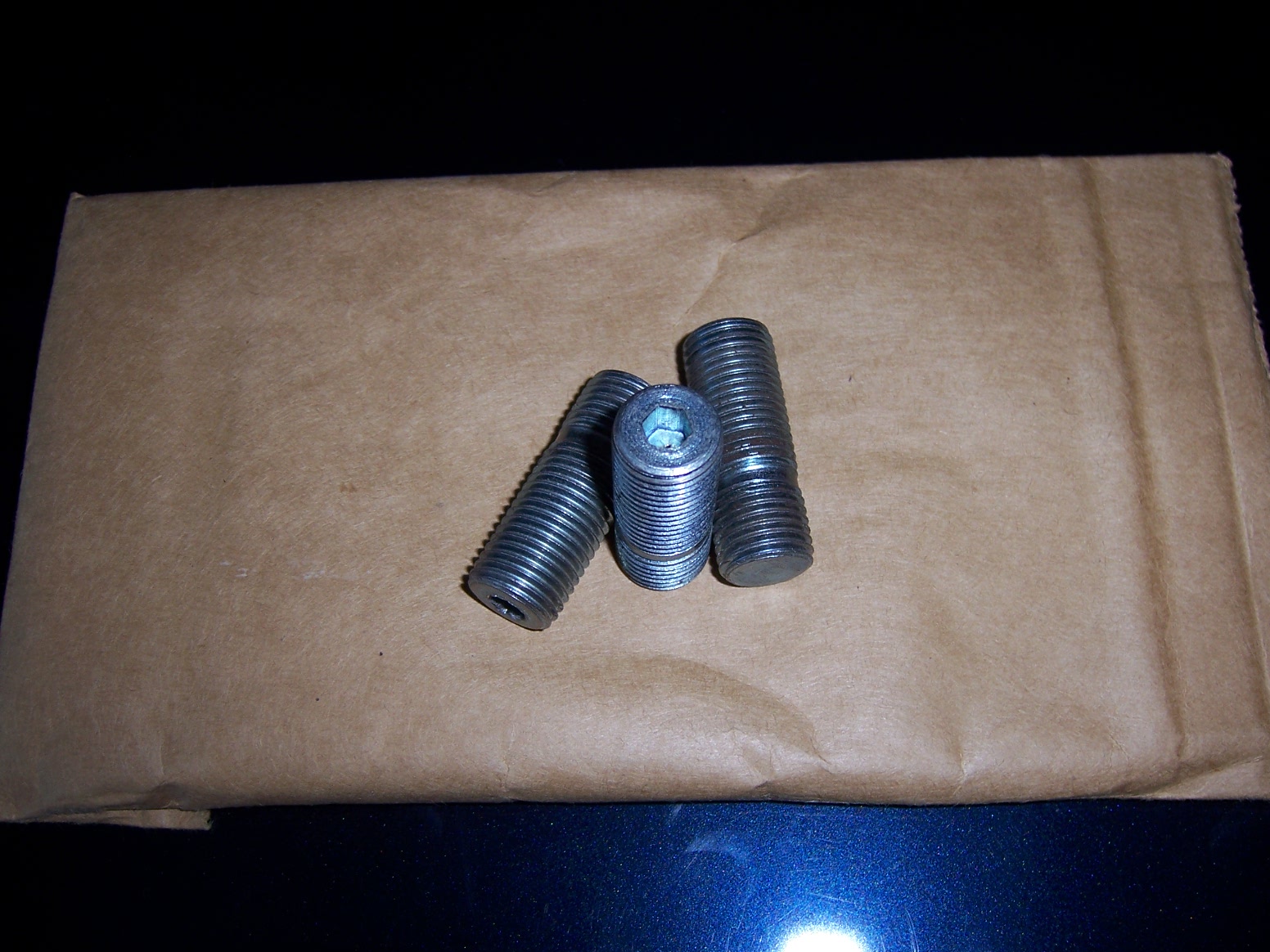

if its EMPI wheels, you need to replace with the chrome type. the wheel will have a flat mating surface, thats why you have that flat washer there. You NEVER use OEM lug nuts on aftermarket wheel.
I just checked and have three of those studs in my 914 parts bin, here is a pic; this is not the FS forum, but I will sell these three studs for $13.00 shipped to TX. they are NOS. + You will need to separate the chrome part and thread on this new piece. PB Blaster and a little heat to separate the stripped part. let me know, or you can source locally, but these are usually hard to find in FLAPS.

Here's what my studs look like now. http://i737.photobucket.com/albums/xx19/19...zpsa750e0d3.jpg What you have looks to be exactly what I need.
