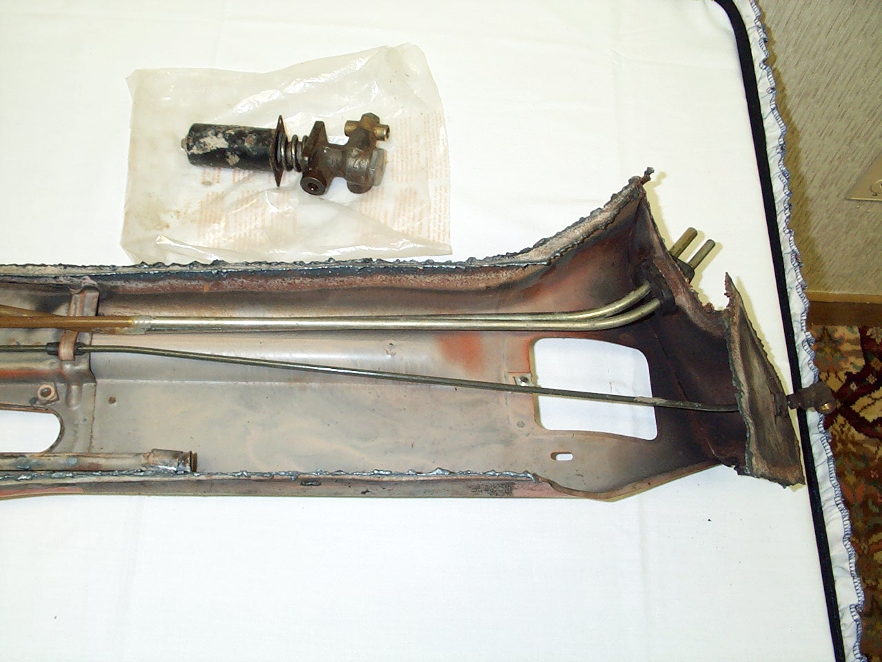

Well then. Maybe I misunderstood- plastic lines run the length of the tunnel? Apparently, in its history, someone replaced the lines IN the tunnel with steel but joined them to the plastic via 7/16 fuel hose and hose clamps, inside the tunnel, under the rear access panel.
I inclined to leave them as is.
Dave_Darling
post Jun 9 2014, 08:40 PM
914 Idiot
Posts: 15,335
Joined: 9-January 03
Member No.: 121
QUOTE(Mikedrevguy @ Jun 9 2014, 03:13 PM) *
Not quite the length. Below, you can see a photo of a cut-away center tunnel. (Literally cut, I think with a plasma cutter.) Note that the front of the lines are metal, but most of the length of the line is plastic. No clamps, just flanges for a strong friction fit.
(IMG:http://www.914world.com/bbs2/uploads_offsite/www.pelicanparts.com-121-1402368048.1.jpg)
--DD
