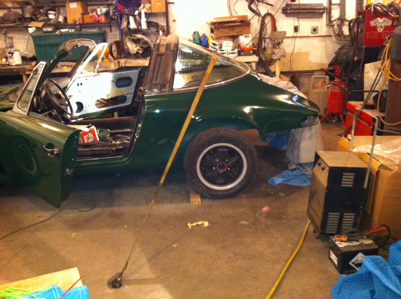

Here's how you install a 911 Targa window. Ratchet strap, floor anchors and lots of fear! (IMG:style_emoticons/default/unsure.gif) There's about 100 psi on that strap. it's tight!
I may be contacting you about this method in a couple months. I'm not looking forward to this job (IMG:style_emoticons/default/unsure.gif)
