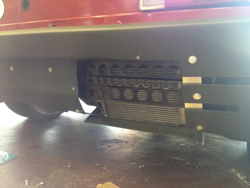

Jetsetsurfshop   New bumper exit. I think I've been building up...   Jun 15 2014, 09:02 AM
ablesnead   Shane that screening reduces airflow about 30 perc...   Jun 15 2014, 09:26 AM
Jetsetsurfshop   Shane that screening reduces airflow about 30 per...   Jun 15 2014, 09:34 AM
Jetsetsurfshop   Took the screen off and added brackets to hold the...   Jun 15 2014, 11:18 AM
Seabird   Took the screen off and added brackets to hold th...   Jun 15 2014, 05:30 PM
Jetsetsurfshop   Took the screen off and added brackets to hold t...   Jun 15 2014, 05:56 PM
Seabird   Cool, I am going to try and bring mine too. Oil, ...   Jun 15 2014, 06:12 PM
