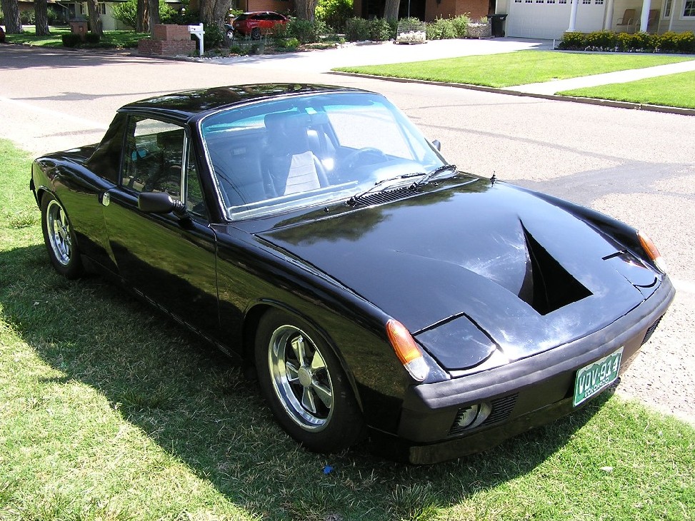

here is my EX race car...
the cooling is great
I have repeated this story to death...
but I ran the same cooler with 3 different air exits
same spec motors over a 10 year period of w2w
each time I improved the air exit I dropped another 10-20F from the oil temp
through the hood was definitely the most effective and that was with the same tiny earls cooler on all versions
