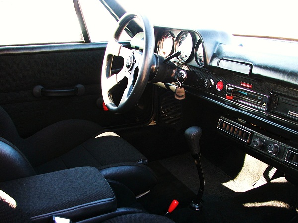

I got a few pics from Scott from Renegade. Pretty nice looking unit overall. Plus doesn't intrude on the drivers side. I didn't like the typical 914 underdash unit as it seemed to get over on the drivers side. Always a little squished there with comfort so didn't want anything more in the way. My passenger get's more room so they can deal (IMG:style_emoticons/default/evilgrin.gif)

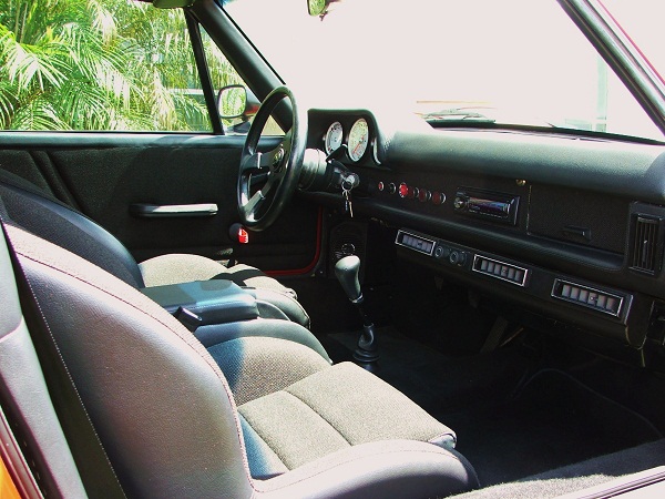

BIGKAT_83   Here ya goTrimline This is what I used on my LS1 c...   Jun 26 2014, 03:47 PM
JRust   Here ya goTrimline This is what I used on my LS1 ...   Jun 26 2014, 03:59 PM
BIGKAT_83   [quote name='BIGKAT_83' post='2054714' date='Jun ...   Jun 26 2014, 04:12 PM
JRust   No...But it does have a duct on the drivers side ...   Jun 26 2014, 04:16 PM
