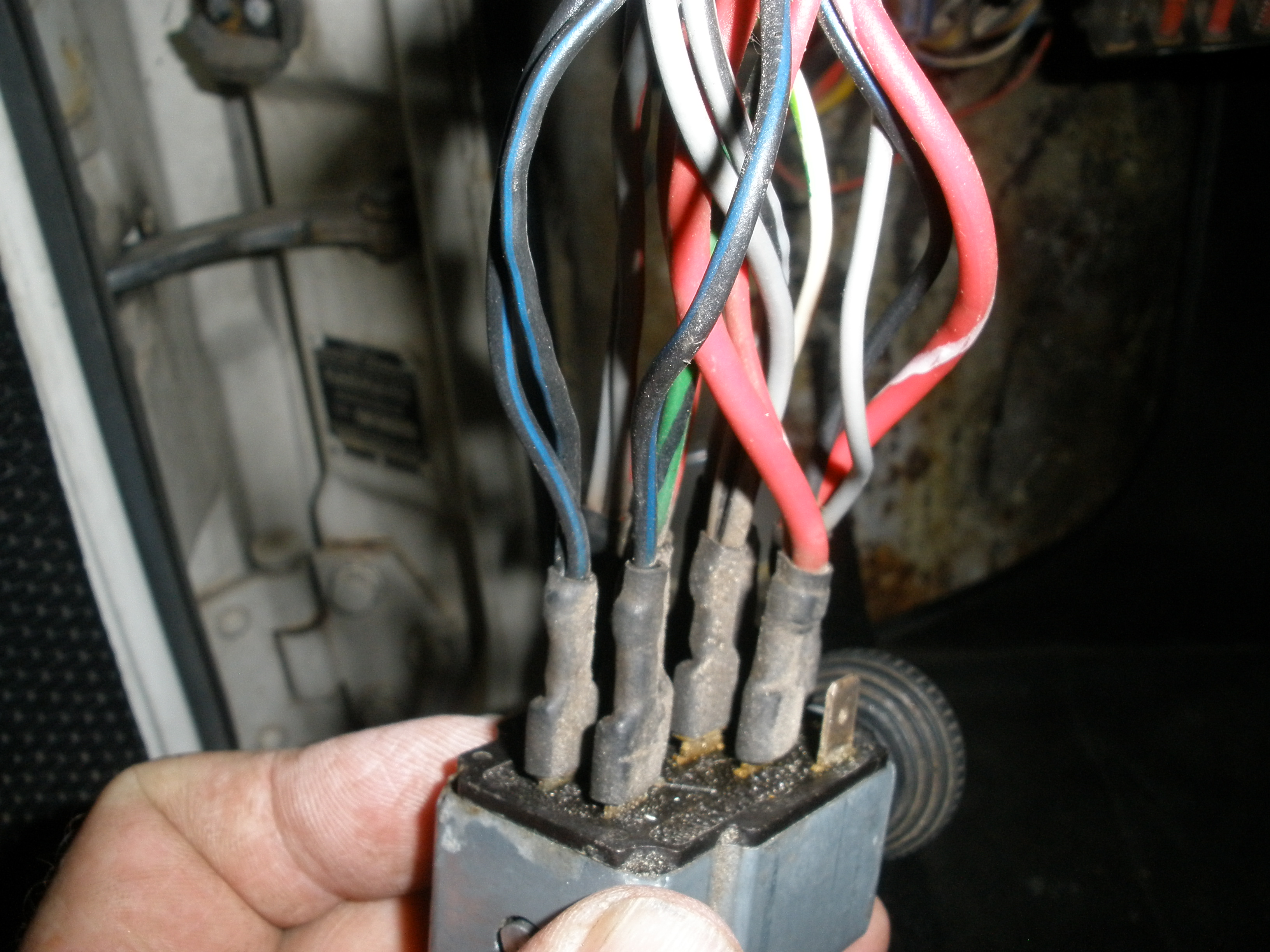

I started my car tonight and noticed despite the headlight switch being fully in the off position, my dash lights are on and my license plate light is .
Odd. Never saw that before. Headlight switch I imagine....
Thoughts?
David
Addedum-and saw what I thought was a wisp of smoke come from under my dash at the windshield....perhaps my imagination?

Much clearer pics, thanks!
D has a red, a red/white, a black/red, and a brown wire. That matches the wiring for the "fresh air" relay. (#54 on diagram part C)
C appears to have a white/yellow, a white/blue, a gray/red, and a red wire. If there is a black tracer on that red wire (could be), that matches the fog light relay wires. (#53 on diagram part A)
Now we know what the relays are.
Dash lights and license plate lights get their power from the main light switch. Find the black/blue wire plugged into the switch and unplug it. If the lights stay on, you are getting power from somewhere else. Very likely a power and ground connection swapped.
--DD

I think I see three of em...

It's hard to tell where things are connected from this angle, but I'd double check the wiring of the headlight switch. It looks like the wires for terminal 58L and 15 might have been swapped. This thread should help.

Interesting thread but his sole observation wasn't verified.
Also, I didn't swap em (the wires) and my system worked fine for quite some time.
Keep in mind that my car is a 1973 and the current (obviously PO replaced) switch is a later model "fat" switch, so the color ID's are different than the thread you so kindly posted.
Perplexed (IMG:style_emoticons/default/headbang.gif)
