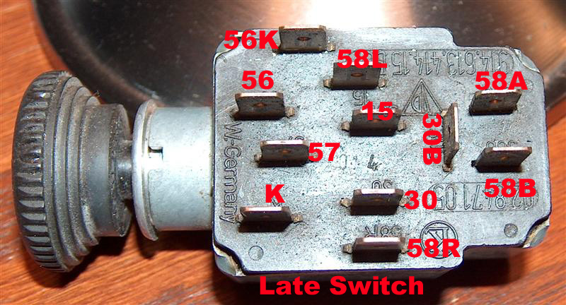

Can any one tell me what color wires go where?

SLITS   56K - Grey 56 - red w/white trace & black w/b...   Aug 9 2011, 05:22 PM
raw1298   56K - Grey 56 - red w/white trace & black w/...   Aug 9 2011, 05:26 PM
Cap'n Krusty   I'll try REAL hard not to be too Krusty here. ...   Aug 9 2011, 06:30 PM
raw1298   I'll try REAL hard not to be too Krusty here....   Aug 9 2011, 07:03 PM
76-914   I'll try REAL hard not to be too Krusty here...   Aug 10 2011, 07:42 AM
Cap'n Krusty   I'll try REAL hard not to be too Krusty here...   Aug 10 2011, 09:47 AM
r_towle   I'll try REAL hard not to be too Krusty here....   Aug 10 2011, 02:13 PM
SLITS   I'll try REAL hard not to be too Krusty here...   Aug 10 2011, 05:41 PM
jim_hoyland   Got a follow up question to the headlight switch w...   Aug 10 2011, 09:26 AM
SLITS   Well Jimmy ... ya gotta think about it ... What c...   Aug 10 2011, 01:36 PM
jim_hoyland   Thanks Ron, that gets me started in the direction ...   Aug 10 2011, 02:39 PM
r_towle   Thanks Ron, that gets me started in the direction...   Aug 10 2011, 02:48 PM
jim_hoyland   Thanks Ron, that gets me started in the directio...   Aug 10 2011, 04:20 PM
jim_hoyland   Note: Diagram of the late switch may be in error. ...   Aug 13 2011, 05:25 PM

LUX-PIERRE   hello sir, I am from Belgium and I have a 914/1800...   Jun 12 2024, 03:51 AM
davep   Can you post a photo of your switch, and perhaps t...   Jun 12 2024, 07:13 AM
LUX-PIERRE   Ok   Jun 12 2024, 10:01 AM
davep   Can you post a photo of your switch, and perhaps t...   Jun 12 2024, 07:19 AM
LUX-PIERRE   Can you post a photo of your switch, and perhaps ...   Jun 12 2024, 10:32 AM
LUX-PIERRE   photo impossible file too long.......................   Jun 12 2024, 10:37 AM
LUX-PIERRE   photo impossible file too long......................   Jun 12 2024, 11:46 AM
mgarrison   photo impossible file too long......................   Jun 12 2024, 01:33 PM
LUX-PIERRE   I bought the car like that!! what can I do...   Jun 12 2024, 12:40 PM
JeffBowlsby   I bought the car like that!! what can I d...   Jun 12 2024, 02:23 PM
LUX-PIERRE   thanks for everything guys!! but I succeed...   Jun 13 2024, 03:44 AM
mgarrison   Maybe this helps... :confused:   Jun 12 2024, 10:04 AM
JeffBowlsby   That switch is not correct for your 914 1.8L. The...   Jun 12 2024, 12:07 PM
