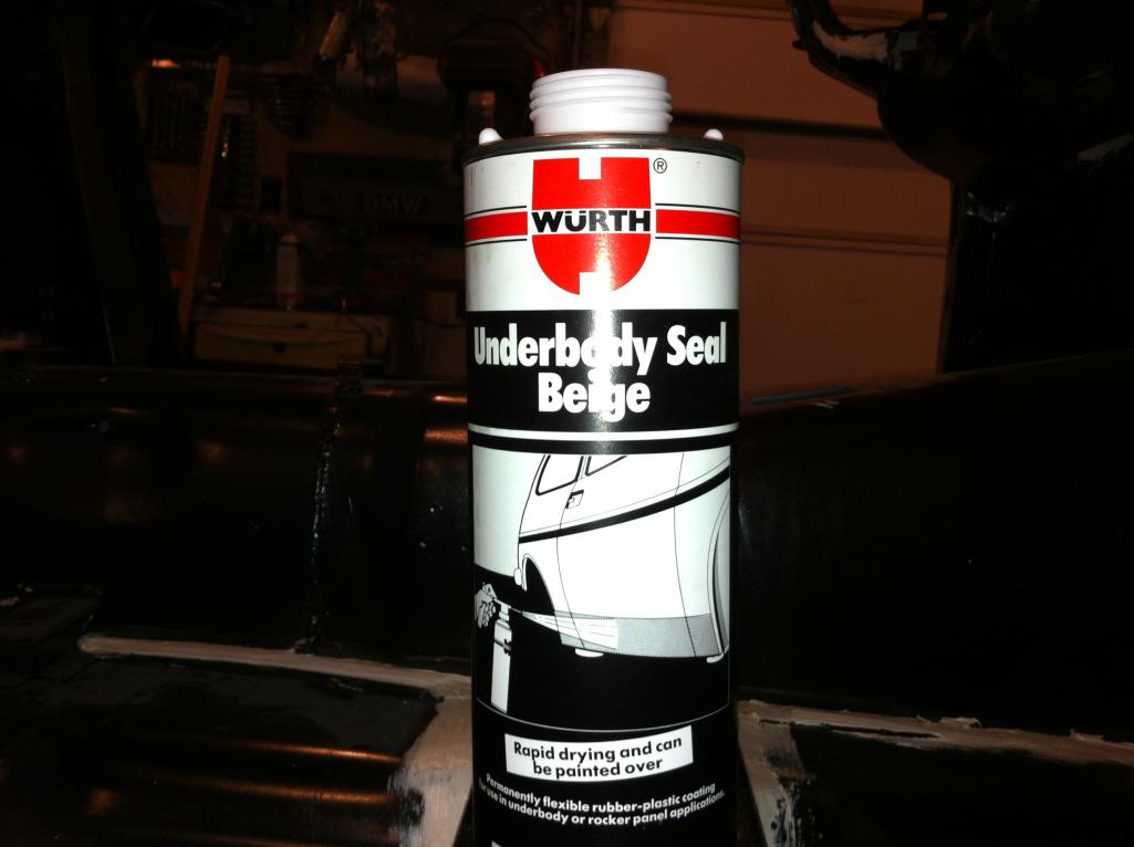

BTW: my friend that owned the Mercedes I'm working on gave me 5 cans of this for the 6.

rick 918-S   BTW: my friend that owned the Mercedes I'm wor...   Jun 29 2014, 07:10 AM
mepstein   BTW: my friend that owned the Mercedes I'm wo...   Jun 29 2014, 08:02 AM
Chris H.   Awesome. You can paint over it and even if you ge...   Jun 29 2014, 09:45 AM
