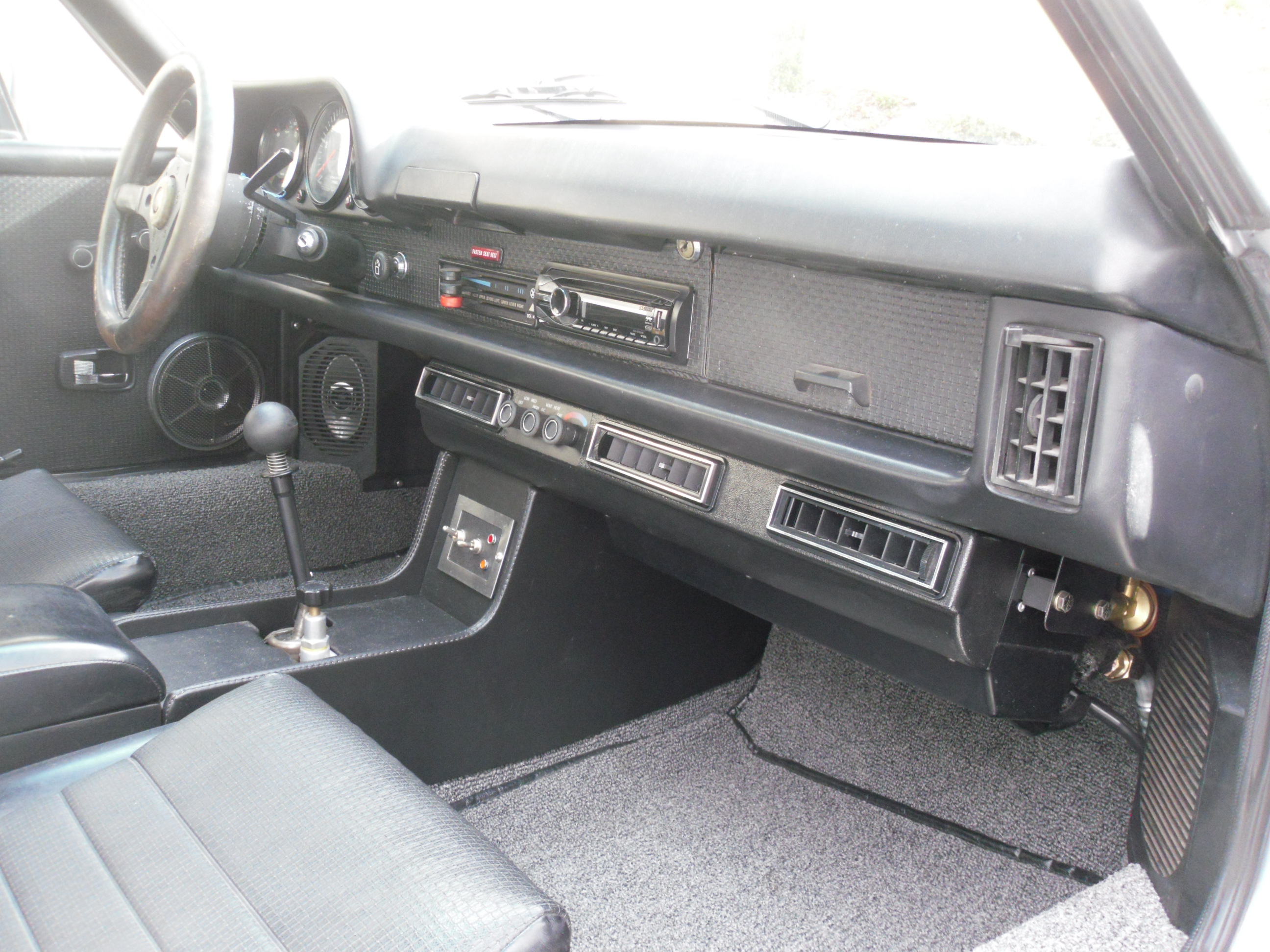

Here ya goTrimline This is what I used on my LS1 car. This is far easier than the one I'm doing for my Subaru car.

My Hot Rod Air under dash unit looks nearly identical to Bob's Southern Air unit. Pretty straight forward install....Routing the hoses is a much bigger challenge however.
