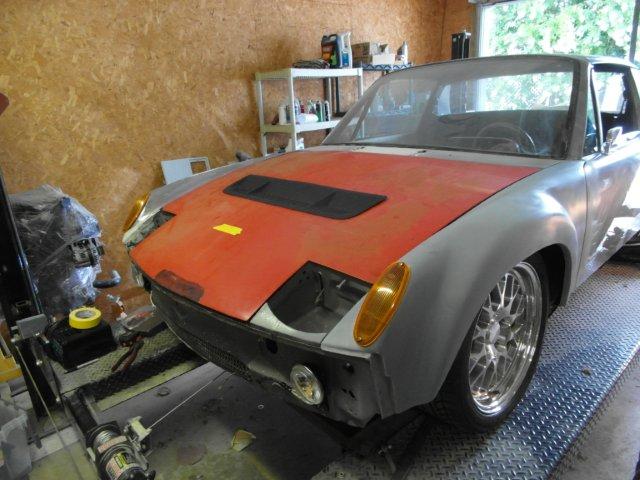

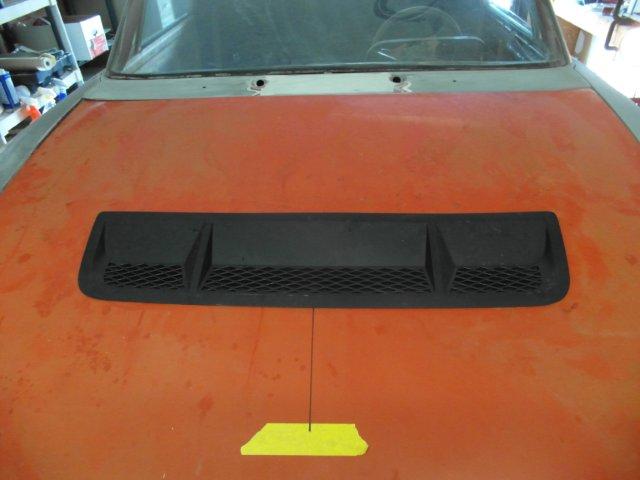

When you add the condenser in front of the radiator your going to need a little more cooling. I added a hood vent and just did this. This is on a junk hood. I didn't want to cut a good hood until I knew it would fit.
