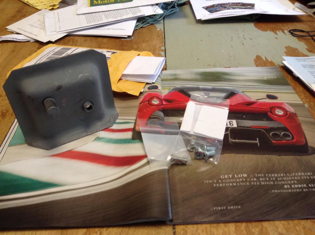

Mini Christmas in July! My door catch screws, e-brake handle pin, and e-brake pivot plat arrived today. This weekend I will weld in the pivot plate and the seat belt mounting points. (IMG:style_emoticons/default/welder.gif)
