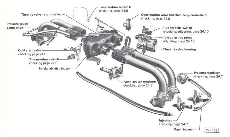

My 1.7 FI is suddenly running rich. I have not changed anything i am aware of. I sometimes have a lose injector plug but that's it. Any suggestions where to start troubleshooting?

Cold start injector is attached to the air plenum....see picture:

lennyhope Doh! Where is the cold start injector?? Jul 5 2014, 03:37 PM
