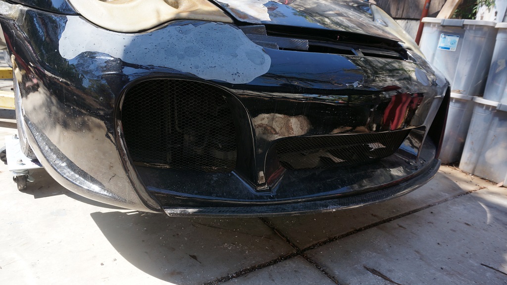

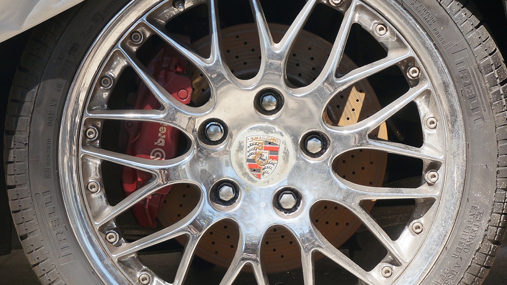

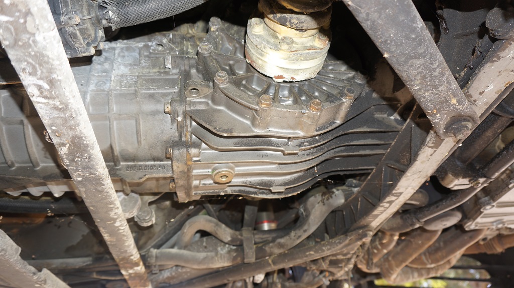

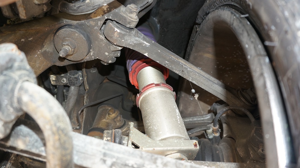

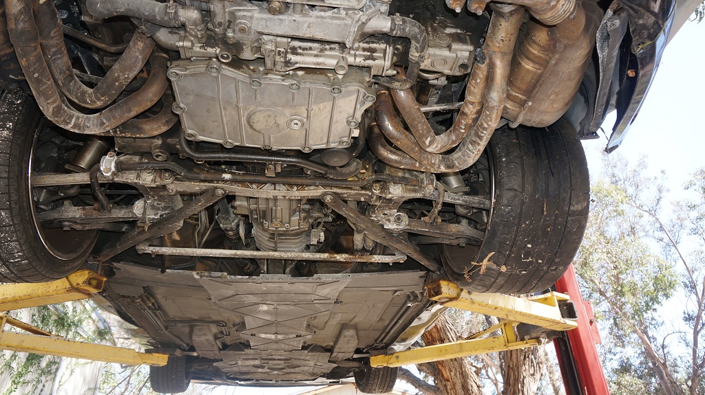

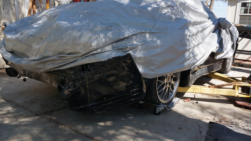

Curbandgutter   Well it has been a while but I have been collectin...   Aug 4 2014, 01:13 PM
Elliot Cannon   Well it has been a while but I have been collecti...   Aug 4 2014, 02:10 PM
ThePaintedMan   We're gonna have to see some pictures. If we...   Aug 4 2014, 06:43 PM
BIGKAT_83   Well it has been a while but I have been collecti...   Aug 5 2014, 08:01 AM
Curbandgutter   Well it has been a while but I have been collect...   Aug 5 2014, 11:50 AM
Justinp71   Sounds like a good project... funny, one just sold...   Aug 4 2014, 01:31 PM
Curbandgutter   Sounds like a good project... funny, one just sol...   Aug 4 2014, 04:44 PM
Curbandgutter   damm iphone will not hook up to my computer. I...   Aug 4 2014, 04:11 PM
76-914   You need that harness up to the 14pin connector at...   Aug 4 2014, 06:23 PM
Curbandgutter   George, Thank you....I know what you mean. Hopefu...   Aug 4 2014, 06:47 PM
Curbandgutter   OK here are some pictures.   Aug 4 2014, 06:51 PM

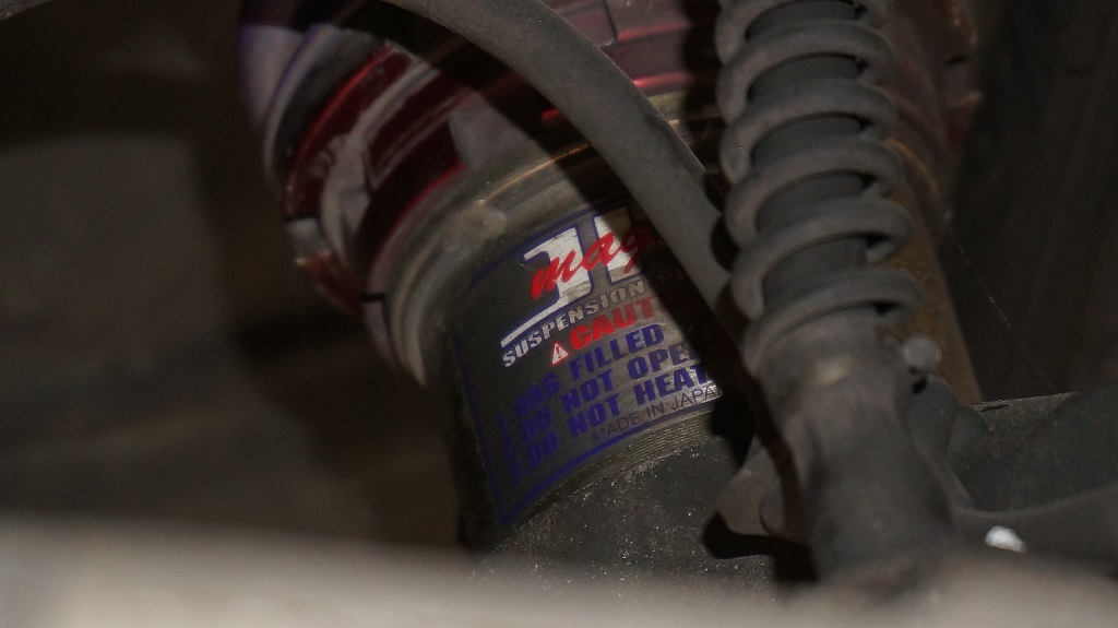

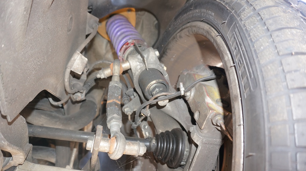

Curbandgutter   And here is the front suspension. I'll be pow...   Jun 17 2016, 07:56 PM
