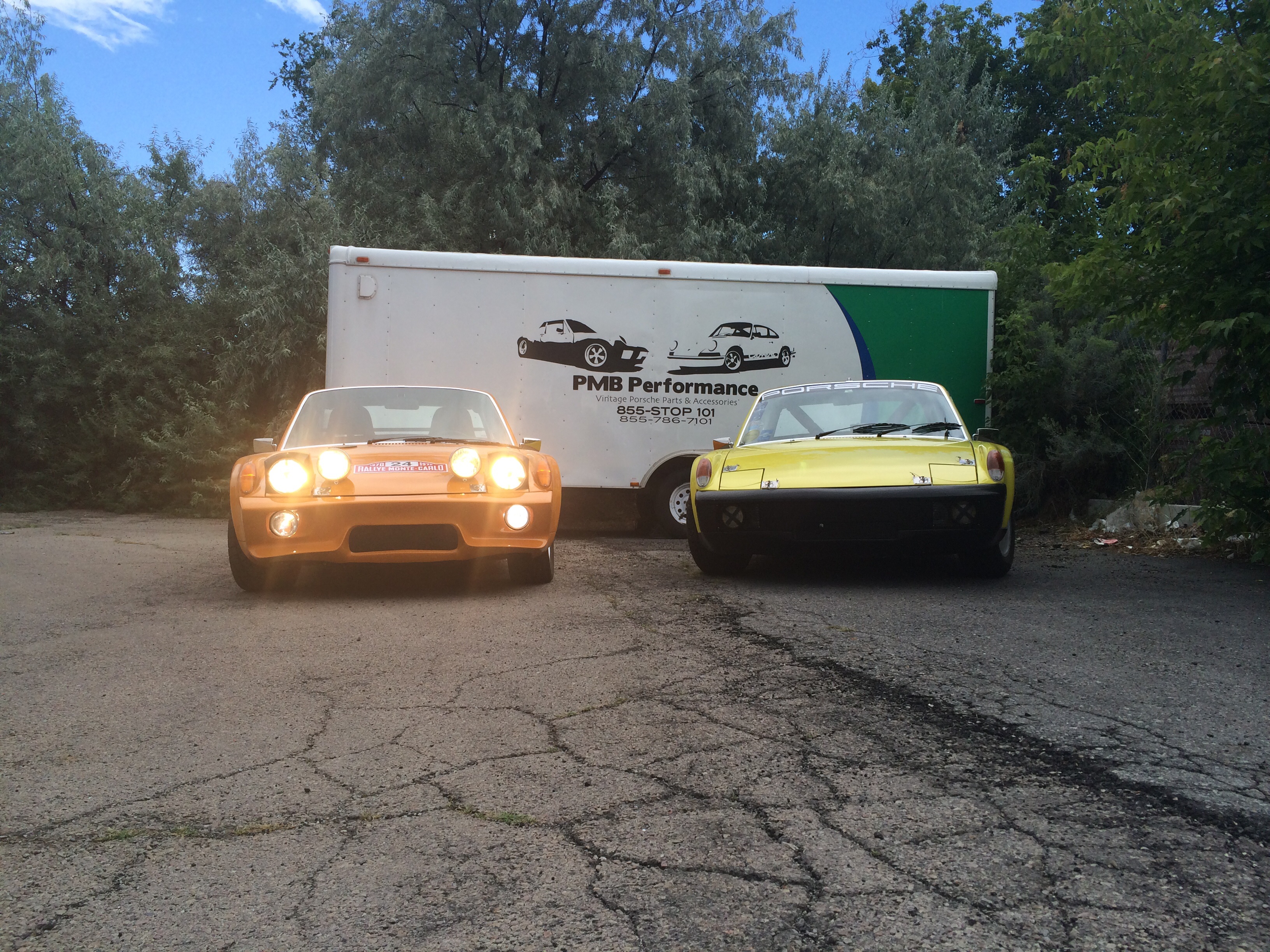

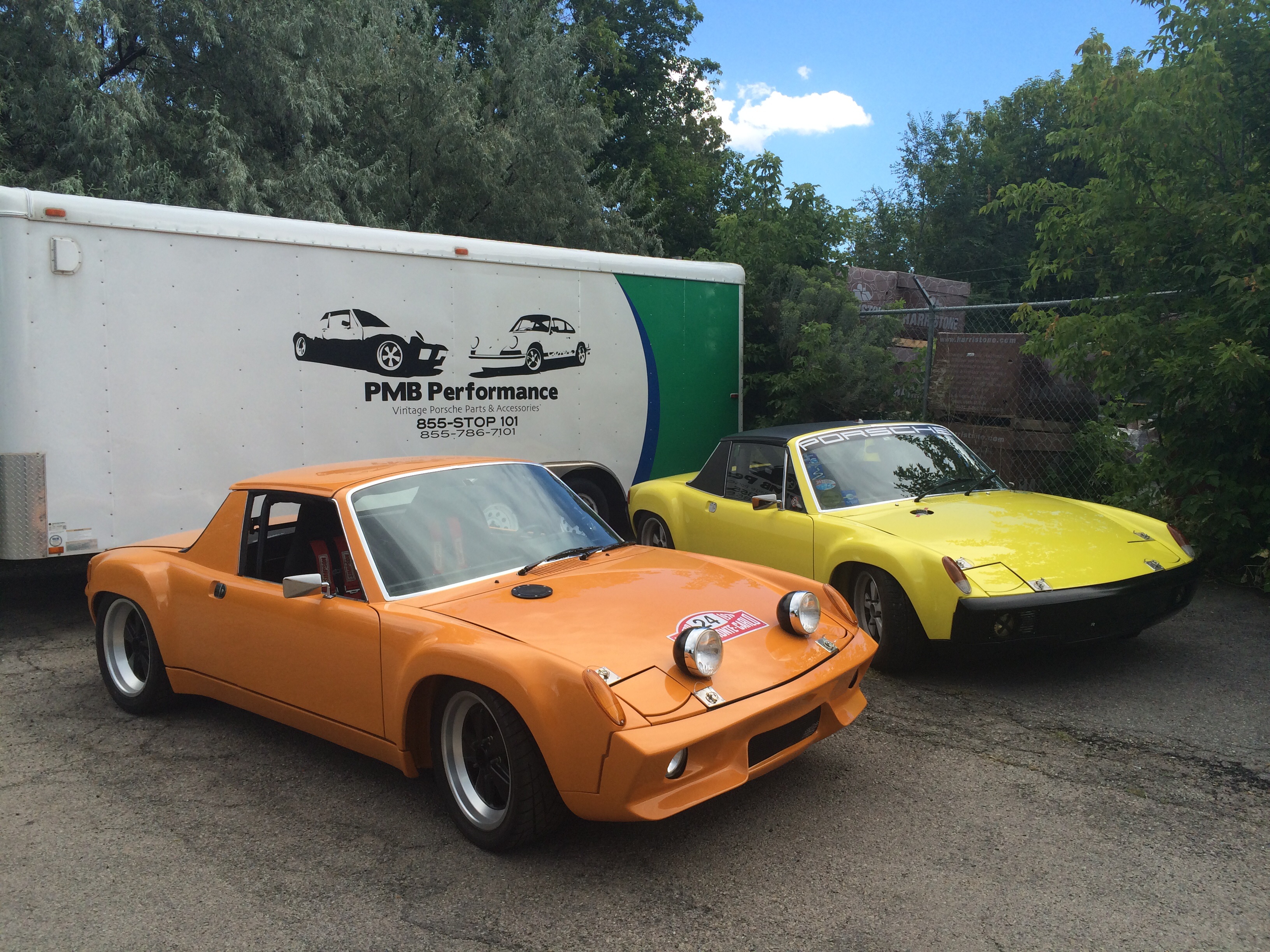

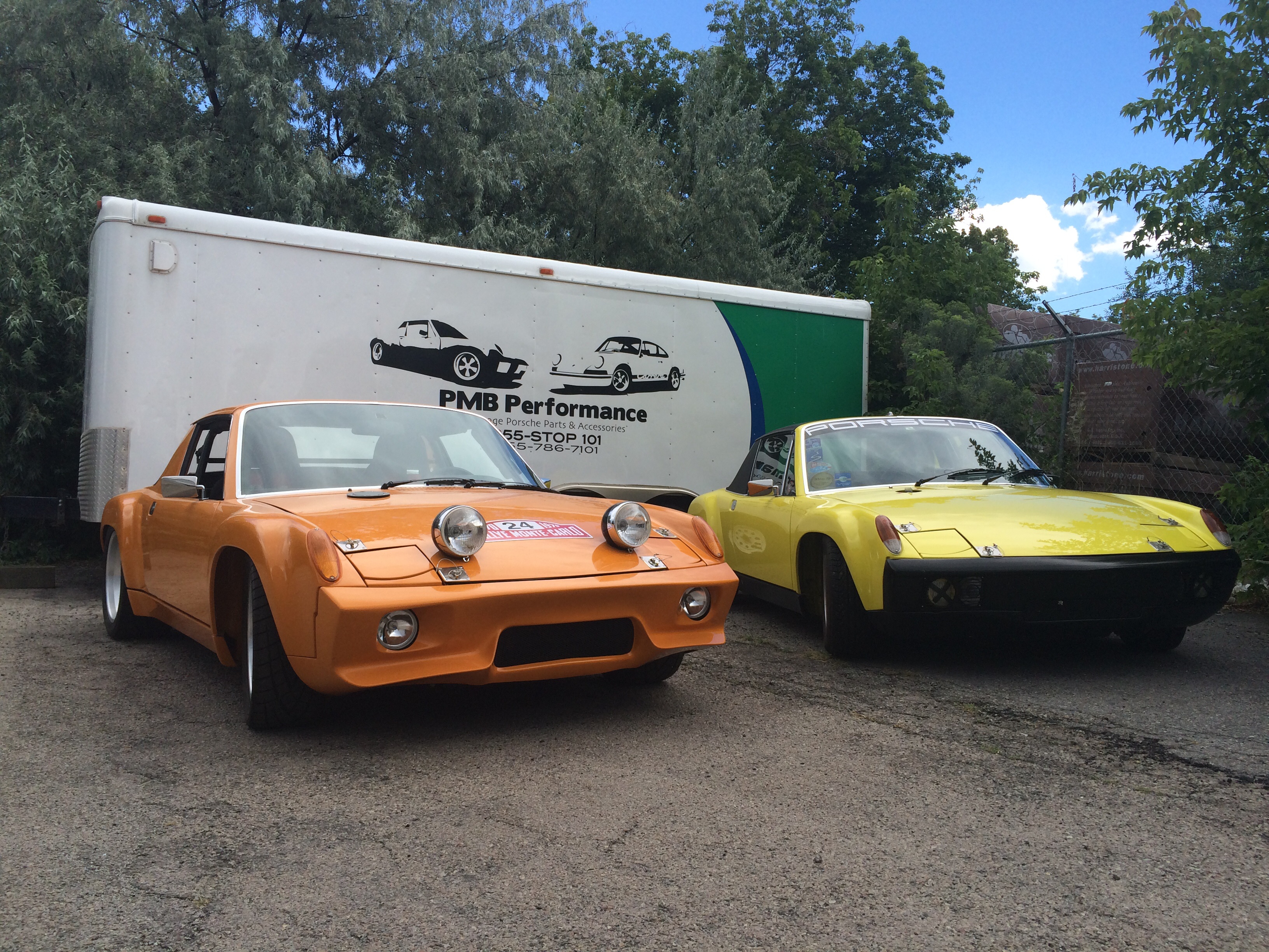

All done. Back to Mike and off to run at Miller Motorsports Park tomorrow.
Still looking to sort out a window solution for the full Lexan panes.
The car ended up eating another turn signal switch and that was the last straw. The dash harness was the last stronghold of "interesting" wiring. We bit the bullet and went all in. From left to right across the dash. All switches, all gauges... everything was sorted and put back to factory condition. A few melted wires in the big rats nest appear to be the culprits.
We took a few pictures before we gave her back. Enjoy.
