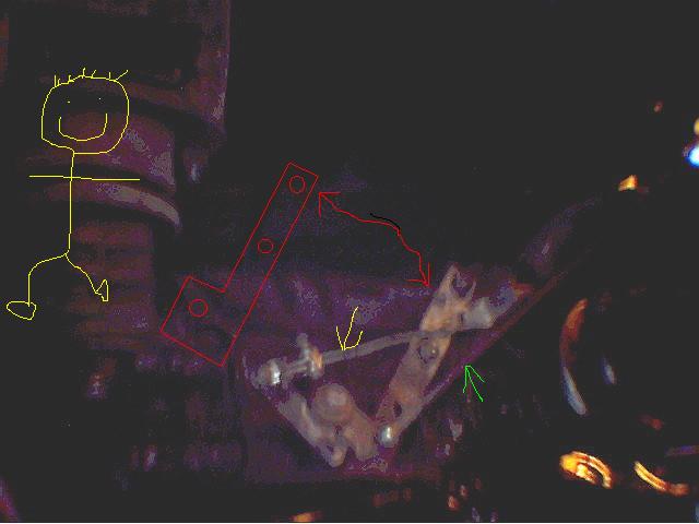

QUOTE(michel richard @ Aug 18 2004, 09:54 AM)
I know you said not to think about it too much, but could you give approximate dimensions and angles for the throttle capble bracket ?
What do you use for the cable itself ?
Michel Richard
Well, before I can take better pictures, let me butcher one up a little. In this picture, you can sort of make out the pieces I made. The mounting bar is pointed out in red and a rough outline made up with the three holes I drilled for it. 2 for mounting to the transmition and one the crank pivots on. The yellow arrow is the stock 914-4 cable, not modified at all. The green arrow is my rod I made for $1.99. Heck, so far this is my best bell crank. Maybe I will just crank out a few and offer them up for sale for like $50? Even with buying the little "cups", it is only about $15 in parts.
Then I decided to express my artistic side. What do you think? (IMG:style_emoticons/default/biggrin.gif)
