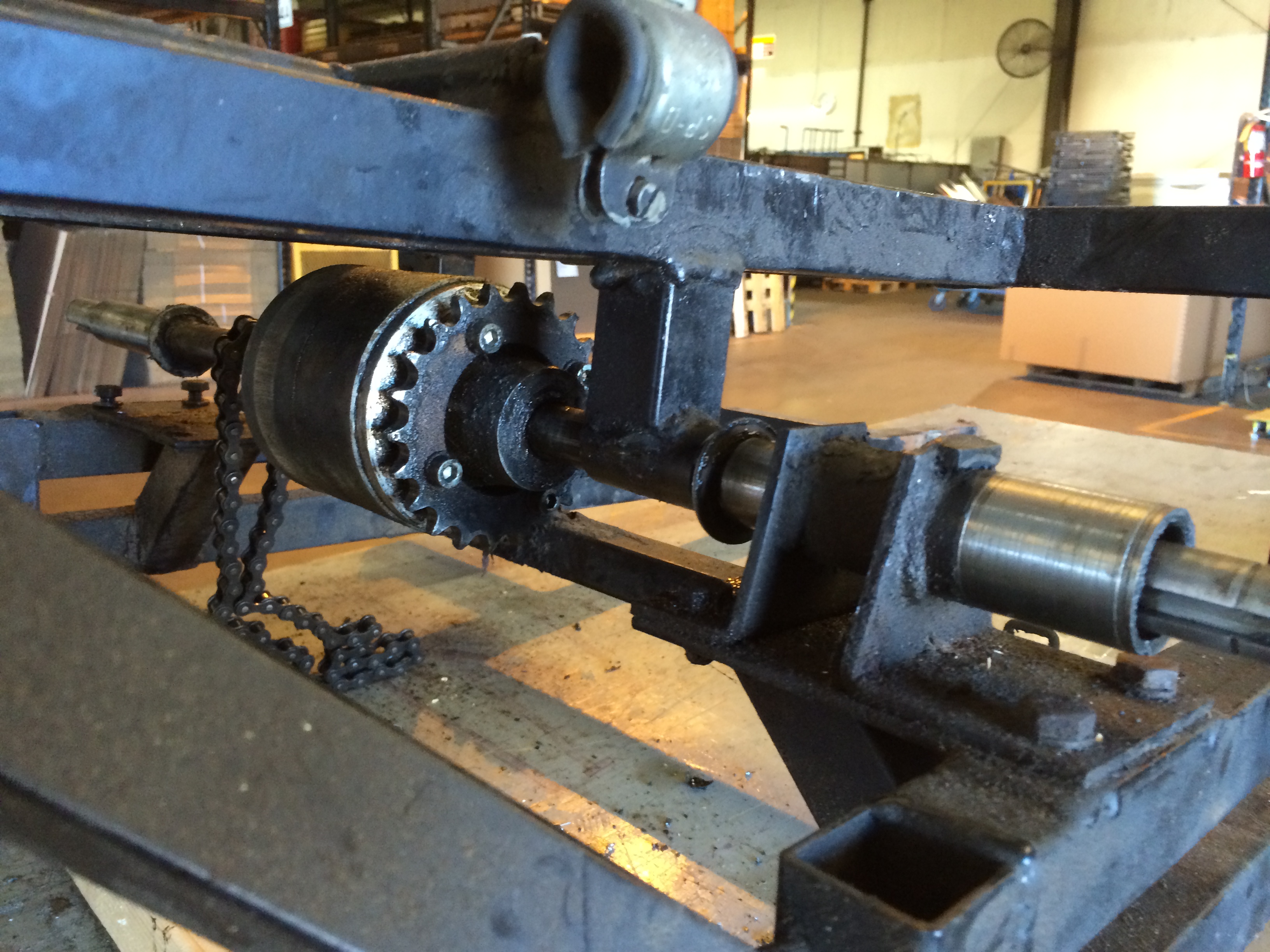

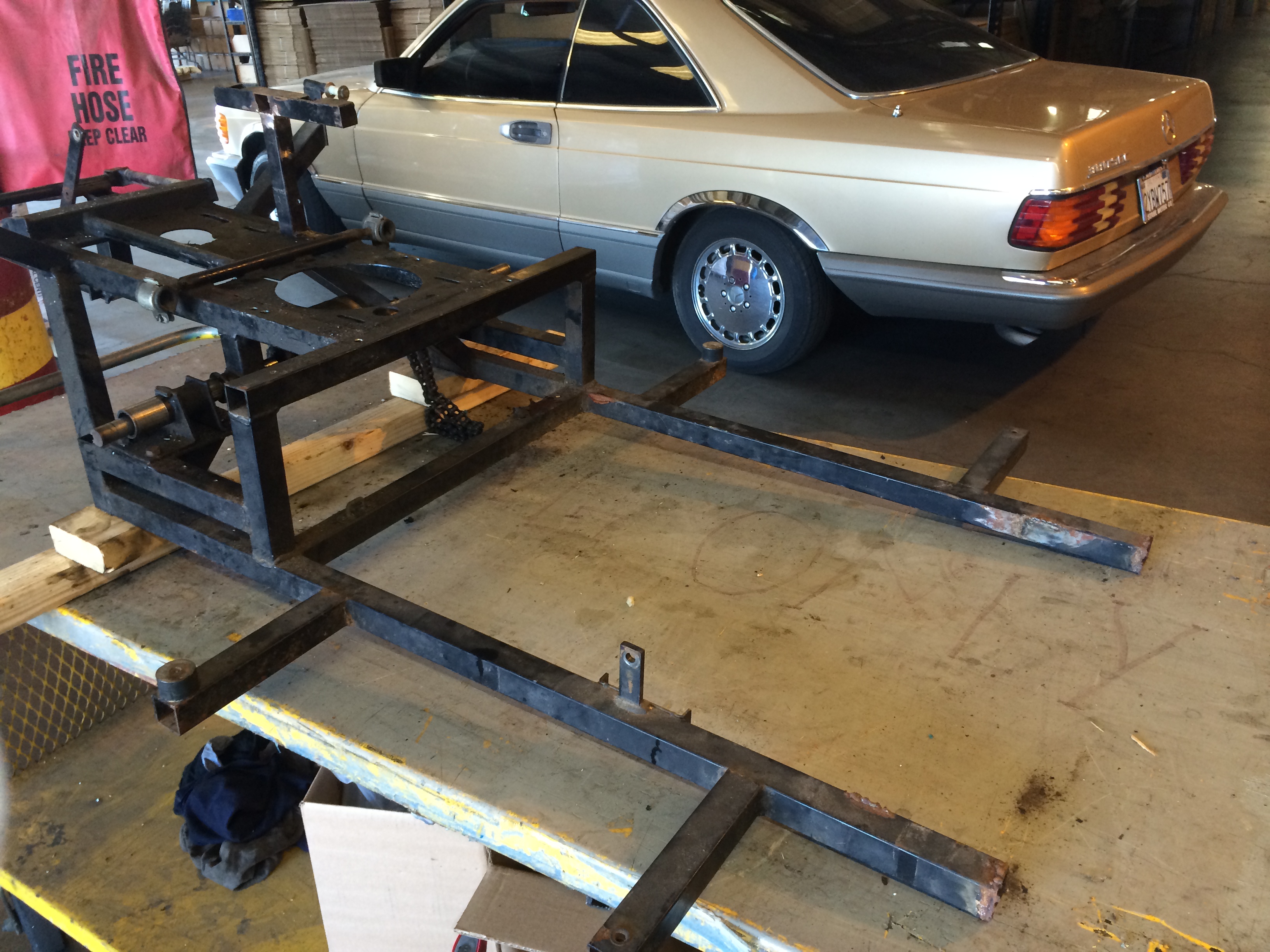

Almost got it stripped. Just need to remove the differential and the I can begin the repair welding. Car took a hit to the left front and entire front end fell off at some butt welded square tubing. I'm going to cut all of it off, square it up and reattach it.
Differential unit is proving fun to remove also.
