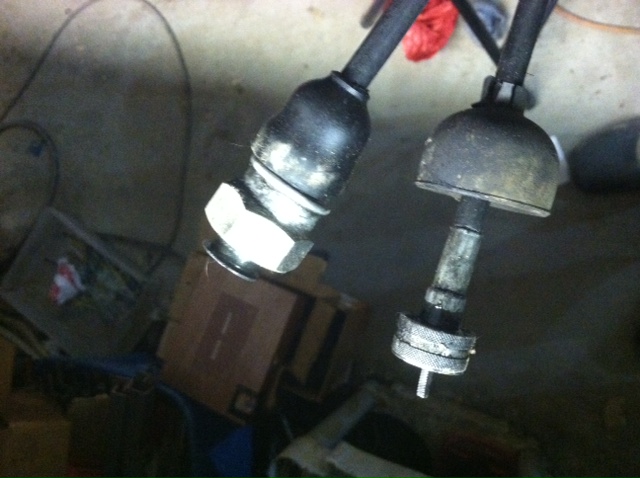

Here is a pic of my new speedo cable. This is the tranny end. The boot appears to be on the wrong way. Got this from the bird. Any one else have this issue? I am starting to loose faith in these guys.

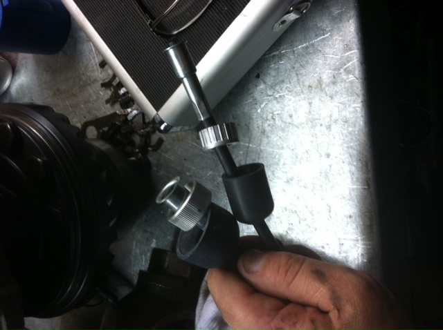

OK, I just replaced my speedo cable with a new Gemo one and now understand the issue that prompted the start of this thread.
See the pics. The old and the new are different. The boot on the firewall end is too small on the new one, and the collar on the gauge end is not captive like on the OE one. Makes for a bit of fun. Best way to install is to put tape on the gauge end just behind the collar to keep the collar from sliding back.

Dr Evil   How is that on the wrong way? It is supposed to sl...   Aug 23 2014, 03:19 PM
mepstein   its correct. you'll see when you install.   Aug 23 2014, 03:33 PM
jeffdon   its correct. you'll see when you install. H...   Aug 23 2014, 03:40 PM
Dr Evil   Jeff, I am not following you. You dont take it off...   Aug 23 2014, 03:48 PM
JawjaPorsche   Jeff, I am not following you. You dont take it of...   Aug 23 2014, 04:30 PM
jeffdon   Jeff, I am not following you. You dont take it of...   Aug 23 2014, 06:25 PM
mepstein   Jeff, I am not following you. You dont take it o...   Aug 23 2014, 06:44 PM
jeffdon   [quote name='jeffdon' post='2077336' date='Aug 23...   Aug 23 2014, 08:05 PM
bluhun   [quote name='jeffdon' post='2077336' date='Aug 2...   Aug 24 2014, 01:51 AM
bluhun   [quote name='jeffdon' post='2077336' date='Aug 2...   Aug 24 2014, 02:05 AM
bluhun   [quote name='jeffdon' post='2077336' date='Aug 2...   Aug 24 2014, 02:20 AM
jeffdon   [quote name='jeffdon' post='2077372' date='Aug 23...   Aug 24 2014, 06:41 AM
bluhun   [quote name='jeffdon' post='2077372' date='Aug 2...   Aug 24 2014, 09:14 PM
Dr Evil   Here is the official pic from the PET. The lower p...   Aug 25 2014, 08:37 AM
Dr Evil   OK, I just replaced my speedo cable with a new Gem...   Sep 5 2014, 06:50 AM

rgalla9146   I don't know about the bulkhead boot. I do k...   Sep 5 2014, 07:56 PM
ClayPerrine   The boots have been reversed on the cables for yea...   Sep 6 2014, 07:09 AM
Jeffs9146   The boots have been reversed on the cables for ye...   Sep 6 2014, 09:44 AM
rgalla9146   The problem is not with the boots. It's a hard...   Sep 6 2014, 08:15 AM
