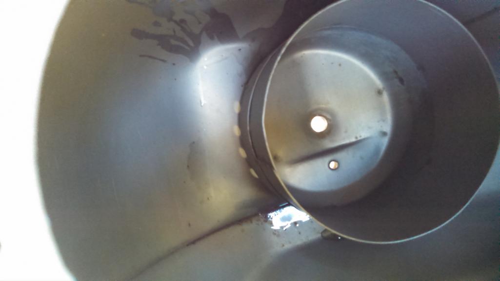

So, I start the process of replacing my fuel pump today (which has been relocated up front by PO). So I got the tank out and it was starting to look pretty "rusty". So I figured I woul attempt to strip it down and repaint it. I have gotten most of the paint stripped off, but how am i going to get some/all of this surface rust off?
Any good radiator shops in San Ramon area I could drop it off to have someone finish it for me this week? Note: the inside of the tank looks very good....as if someone re-did the tank sometime ago.

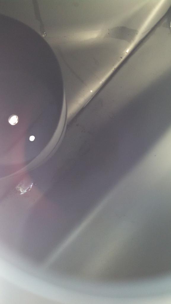

boxsterfan
post Sep 6 2014, 06:41 PM
914's are kewl
Posts: 1,776
Joined: 6-June 03
From: San Ramon, CA
Member No.: 791
Inside the tank.

Harpo   You mentioned that the PO had possibly redid the t...   Sep 6 2014, 06:58 PM

Harpo   I believe that both rotary and racer Chris have fu...   Oct 12 2014, 05:42 AM
bdstone914   I bought a bunch of extra crush washers from rotar...   Oct 12 2014, 06:28 AM
mepstein   buy a gallon or 2 of apple cider vinegar. pour in ...   Oct 12 2014, 07:26 AM
cary   I've been in about the same spot for a couple ...   Oct 12 2014, 08:50 AM
mepstein   Vinegar is cheap, works great and no noxious fumes...   Oct 12 2014, 09:41 AM
boxsterfan   Vinegar is cheap, works great and no noxious fume...   Oct 12 2014, 01:41 PM
bdstone914   I have a couple of good clan late tanks. Hear are...   Oct 12 2014, 12:13 PM
boxsterfan   Bruce, thanks for the message. I'm going to tr...   Oct 12 2014, 12:53 PM
mepstein   Bruce, thanks for the message. I'm going to t...   Oct 12 2014, 01:05 PM
bdstone914   Bruce, thanks for the message. I'm going to ...   Oct 12 2014, 01:11 PM
