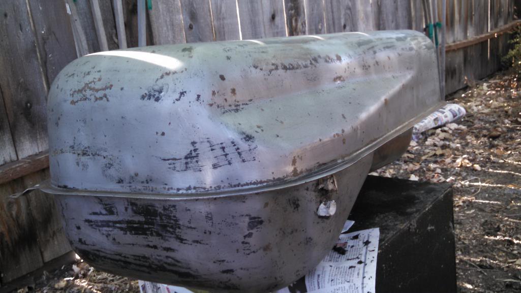

So, I start the process of replacing my fuel pump today (which has been relocated up front by PO). So I got the tank out and it was starting to look pretty "rusty". So I figured I woul attempt to strip it down and repaint it. I have gotten most of the paint stripped off, but how am i going to get some/all of this surface rust off?
Any good radiator shops in San Ramon area I could drop it off to have someone finish it for me this week? Note: the inside of the tank looks very good....as if someone re-did the tank sometime ago.

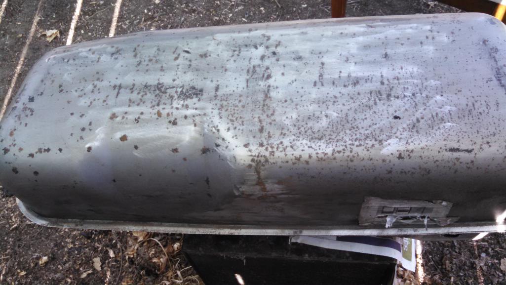

Tank stripped (as far as I could get today). Looking closely, it has lots of surface rust that I need/want to get off. Just want to know the best/easiest way....including a local shop near San Ramon that I could drop it off at.

Mike Bellis   You need to find a powder coating shop. They can b...   Sep 6 2014, 06:51 PM
boxsterfan   You need to find a powder coating shop. They can ...   Sep 6 2014, 06:57 PM
Jeff Bowlsby   There is a shop in hayward...can't recall the ...   Sep 6 2014, 06:55 PM
Harpo   You mentioned that the PO had possibly redid the t...   Sep 6 2014, 06:58 PM
boxsterfan   Electro-Plating Specialties Incorporated 2436 Ame...   Sep 6 2014, 07:04 PM
Mike Bellis   Most powder coating shops have a blaster...   Sep 6 2014, 07:09 PM
boxsterfan   Being the CSOB 914 owner that I am, I was able to ...   Sep 7 2014, 09:27 PM

Harpo   I believe that both rotary and racer Chris have fu...   Oct 12 2014, 05:42 AM
bdstone914   I bought a bunch of extra crush washers from rotar...   Oct 12 2014, 06:28 AM
mepstein   buy a gallon or 2 of apple cider vinegar. pour in ...   Oct 12 2014, 07:26 AM
cary   I've been in about the same spot for a couple ...   Oct 12 2014, 08:50 AM
mepstein   Vinegar is cheap, works great and no noxious fumes...   Oct 12 2014, 09:41 AM
boxsterfan   Vinegar is cheap, works great and no noxious fume...   Oct 12 2014, 01:41 PM
bdstone914   I have a couple of good clan late tanks. Hear are...   Oct 12 2014, 12:13 PM
boxsterfan   Bruce, thanks for the message. I'm going to tr...   Oct 12 2014, 12:53 PM
mepstein   Bruce, thanks for the message. I'm going to t...   Oct 12 2014, 01:05 PM
bdstone914   Bruce, thanks for the message. I'm going to ...   Oct 12 2014, 01:11 PM
cary   Another Google item. As soon as you finish cleanin...   Oct 12 2014, 07:19 PM
