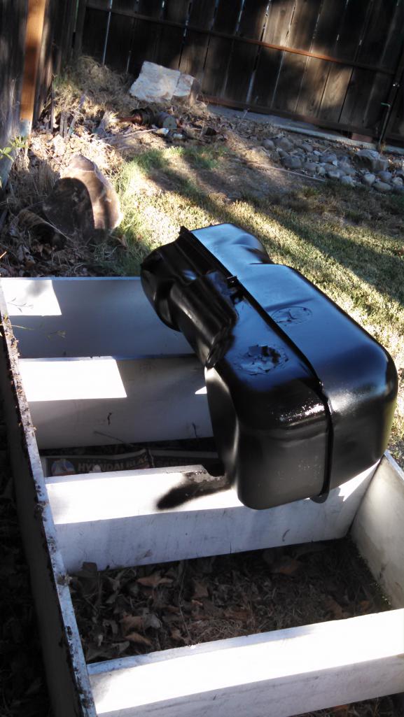

So, I start the process of replacing my fuel pump today (which has been relocated up front by PO). So I got the tank out and it was starting to look pretty "rusty". So I figured I woul attempt to strip it down and repaint it. I have gotten most of the paint stripped off, but how am i going to get some/all of this surface rust off?
Any good radiator shops in San Ramon area I could drop it off to have someone finish it for me this week? Note: the inside of the tank looks very good....as if someone re-did the tank sometime ago.

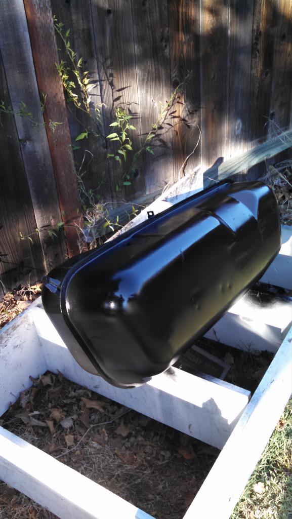

Being the CSOB 914 owner that I am, I was able to get my gas tank repainted today. For the light surface rust I was seeing on the tank after the stripping, I used Evaporust (from your FLAPS nearby). Actually worked very well.
Anyway, two rattle cans later and it looks good to me in gloss black. The inside of the tank is fine. No rust on the outside of the tank, and it has a fresh coat to protect it.
Now I just need to get it back together.
