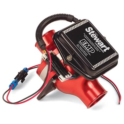

Don't forget flow! The rad needs to be big enough, but you also have to move the coolant to cool properly. Mike Bellis is running a really cool water pump(Mike?What kind again?)Lots of GPH + properly sized rad and fans = cool. Im running a renegade LS cooling kit that also uses an electric pump, and I have zero cooling issues. The renegade kit works, but it can be done way cheaper. Also, the better you can shroud the inlet side of your rad, the better.

QUOTE(speed metal army @ Sep 10 2014, 09:30 PM) *
Super cool pump... (IMG:style_emoticons/default/smile.gif)
