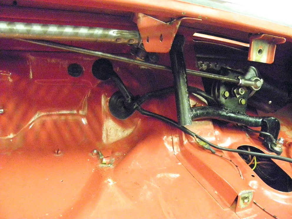

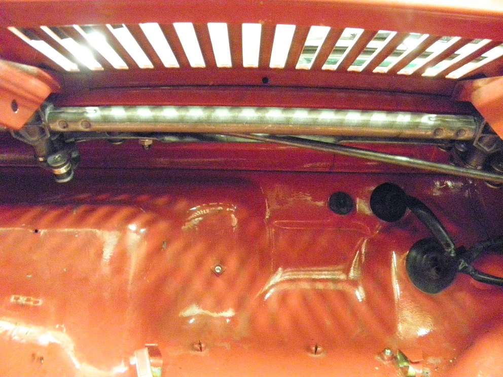

McMark   Differences: - The wiper linkage arm on the Bo...   Jul 22 2012, 10:42 AM
smj   - The bolts and drive shaft on the 914 motor are ...   Jul 22 2012, 04:13 PM
McMark   Here's a couple shots with the cover off. I n...   Jul 22 2012, 11:10 AM
kg6dxn   Great photos! I can really see all the dirt an...   Jul 22 2012, 11:38 AM
McMark   Stock 914 wiper motor looks exactly the same on th...   Jul 22 2012, 01:30 PM

McMark   Here's an image from Kansas_914's build sh...   Jul 22 2012, 02:02 PM
McMark   More work, no benefit. It would work. But in par...   Jul 22 2012, 04:17 PM

McMark   Well, 3.5 years after mocking this up, I actually ...   Nov 28 2016, 10:11 AM
McMark   Well, that was an easy install. No surprises at a...   Nov 28 2016, 01:22 PM
