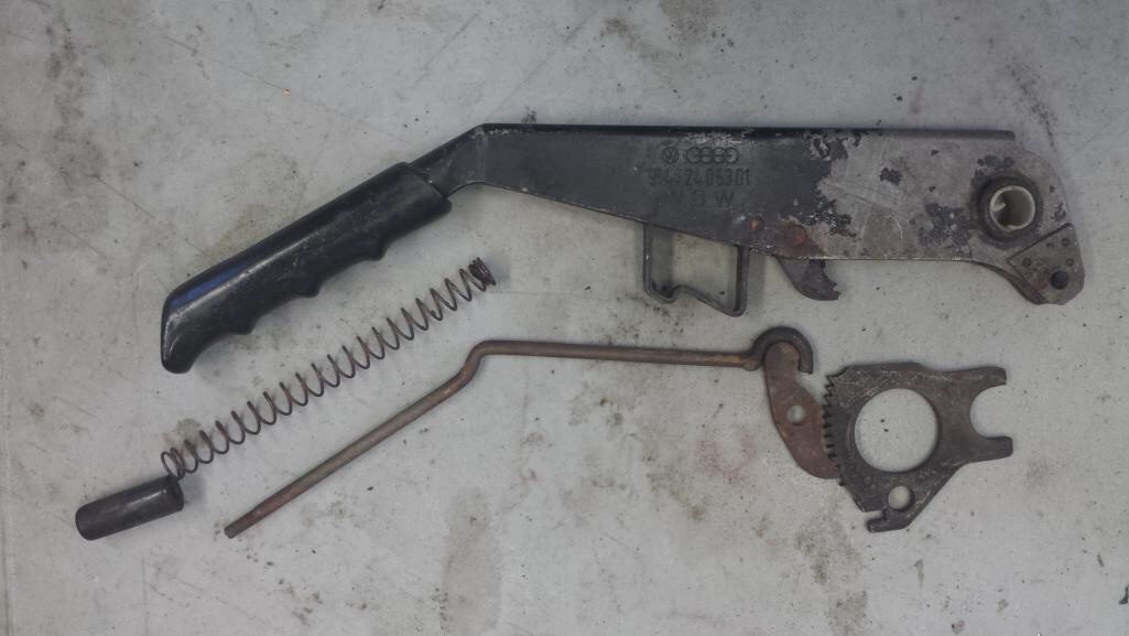

It's a late car; when I pull up on the eBrake handle it doesn't set. It will go back down to the floor. Is a part sticking ?

Here is the layout of the parts.

QUOTE(bdstone914 @ Sep 14 2014, 03:28 PM) *
Which parts are causing the handle to not catch ?

QUOTE(jim_hoyland @ Sep 14 2014, 05:36 PM) *
There are five parts there Jim.
If it isn't catching then any part that dynamically acts on the pawl. The pawl the "toothed" part is the part that catches.
Are you sure it's just not sticking?

QUOTE(914_teener @ Sep 14 2014, 08:43 PM) *
I'll find out when I open it up; that was my thought too.
