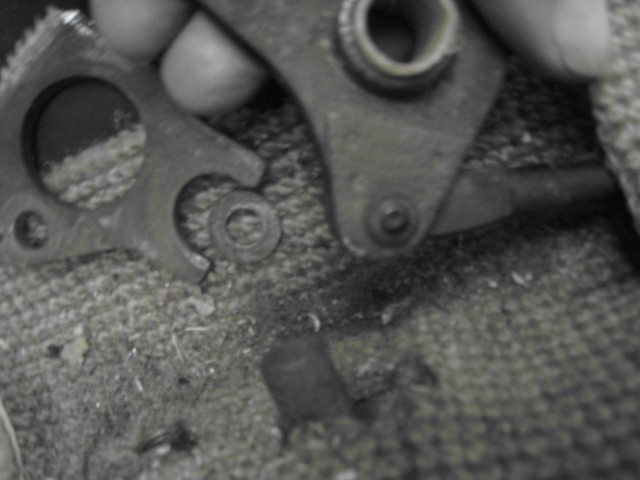

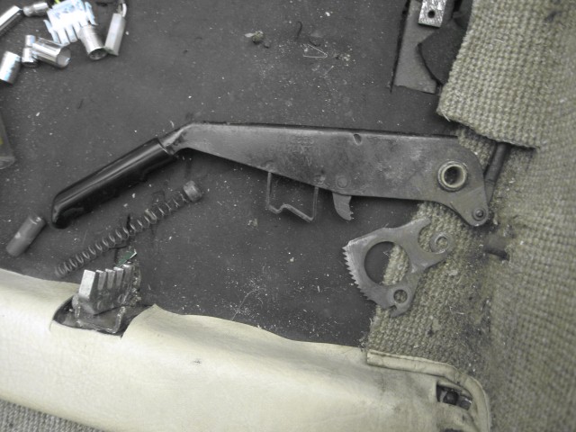

Dissassembled the handle from the body. The rod and pawl are still one piece. The other tooted part looked ok, I'm not sure whether the teeth are too worn.
Couple of questions: How do I release the cable from the back end of the eBrake lever; and, can the teflon bushing be replaced-are they available?
I'm thinking the pawl is not lining up on the catch ?? The real catch had a washer on one side....

jim_hoyland   Unscrewed the button and pulled the spring; spring...   Sep 14 2014, 08:21 AM
Cap'n Krusty   Unscrewed the button and pulled the spring; sprin...   Sep 14 2014, 10:17 AM
mepstein   Unscrewed the button and pulled the spring; sprin...   Sep 14 2014, 04:13 PM

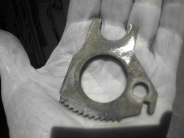

worn   You are going to have to replace the handle. I ...   Sep 15 2014, 04:21 PM

bdstone914   Here is the layout of the parts.   Sep 14 2014, 04:28 PM
jim_hoyland   Here is the layout of the parts. Which parts a...   Sep 14 2014, 06:36 PM
914_teener   Here is the layout of the parts. Which parts ...   Sep 14 2014, 09:43 PM

jim_hoyland   Reassembled after inspection; looks like the teeth...   Sep 15 2014, 03:29 PM
worn   Reassembled after inspection; looks like the teet...   Sep 15 2014, 04:18 PM
Cap'n Krusty   Does the pawl move with the rod? (The rod and paw...   Sep 15 2014, 04:07 PM
worn   It's a late car; when I pull up on the eBrake...   Sep 15 2014, 04:15 PM
jim_hoyland   I can' detach the assembly from the cable at t...   Sep 15 2014, 04:33 PM
SLITS   I can' detach the assembly from the cable at ...   Sep 15 2014, 05:54 PM
