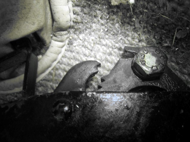

It's a late car; when I pull up on the eBrake handle it doesn't set. It will go back down to the floor. Is a part sticking ?

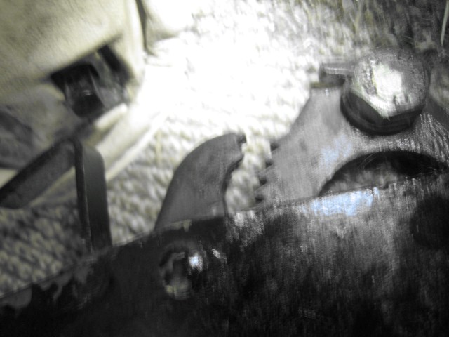

Reassembled after inspection; looks like the teeth on the pawl are worn enough to not lock into the other piece....
Here's a pic... (IMG:style_emoticons/default/sad.gif)

jim_hoyland   Dissassembled the handle from the body. The rod an...   Sep 15 2014, 02:32 PM
jim_hoyland   Reassembled after inspection; looks like the teeth...   Sep 15 2014, 03:29 PM
worn   Reassembled after inspection; looks like the teet...   Sep 15 2014, 04:18 PM
Cap'n Krusty   Does the pawl move with the rod? (The rod and paw...   Sep 15 2014, 04:07 PM
worn   It's a late car; when I pull up on the eBrake...   Sep 15 2014, 04:15 PM
