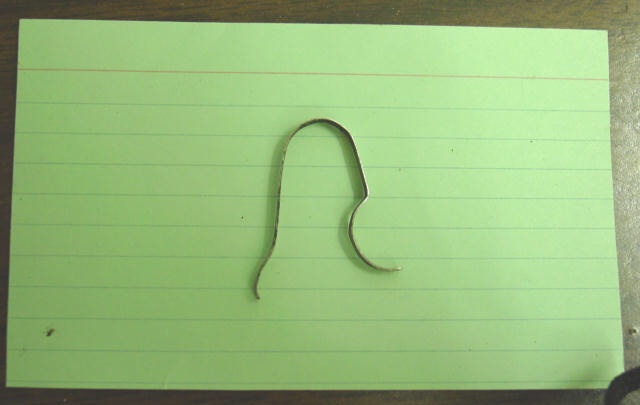

I have a late (75) handle; in reading a pat posting, it appears that early eBrake levers had a short piece of metal sprung to OSH the pawl into the ratchet. Do late handles work the same ?
Here' a pic of the part... And it comes fro: http://www.914world.com/bbs2/index.php?showtopic=79116

76-914   Jim, unscrew the blk plastic knob and look. Sounds...   Sep 14 2014, 07:26 AM
jim_hoyland   Unscrewed the button and pulled the spring; spring...   Sep 14 2014, 08:21 AM
Cap'n Krusty   Unscrewed the button and pulled the spring; sprin...   Sep 14 2014, 10:17 AM
mepstein   Unscrewed the button and pulled the spring; sprin...   Sep 14 2014, 04:13 PM
