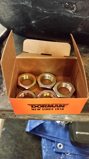

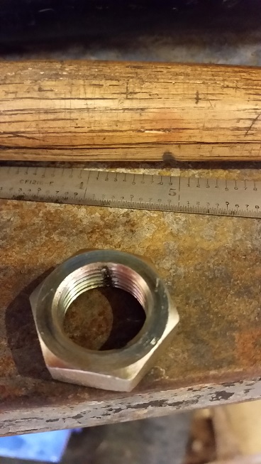

Nuts did the job!
Cut a groove with a triangle file. Worked like charm.
