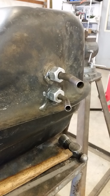

Working on replumbing my new fuel pump. So I decided to loosen the nuts that cinch down the fuel tank output pipes. Big one came off without a hitch. The return line, that's another story. The aluminum nut totally stripped out. Steel bung threads are embedded with aluminum.
Has anyone bought the M18 * 1.0 die or thread restorer and cleaned those threads before? Kind of an odd sized thread.
Hate to give up on this tank.

Had the same problem, didn't want to buy a one time chaser (that's what plumbers call it). I took a dental pick and a wire wheel on my Dremel, and picked at the aluminum for a while. It eventually came clean.

My threads were damaged and I cleaned them up with a thread file. Took about 15 minutes but it worked like a charm

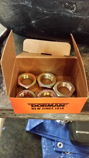

Did a little more research. Looks like the M18*1.0 is the only spindle nut that Nissan/Datsun has ever used. Comes in a Dorman kit or in a five pack.
I think I'll still get the die if its narrow enough to fit between the threads and the flange. I still five more cars awaiting restoration..............

Ordered the Nissan spindle nuts at the flaps. Should be in first thing in the am.

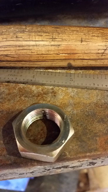

I'm going make a thread restorer with one of them.

Nuts did the job!
Cut a groove with a triangle file. Worked like charm.

When you start to tidy up the threads The main thing is to use oil cutting oil.
Then only turn about a 1/4 to 1/3rd of a turn. Back it off. Clean it again.
Rinse and repeat.

Rock auto
Use 1995 Nissan Pickup. Brake/hub. Comes up as
Spindle Nut. Like $2.

Thanks Cary - order is placed (minimum 5 pieces) $22 shipped to the door.

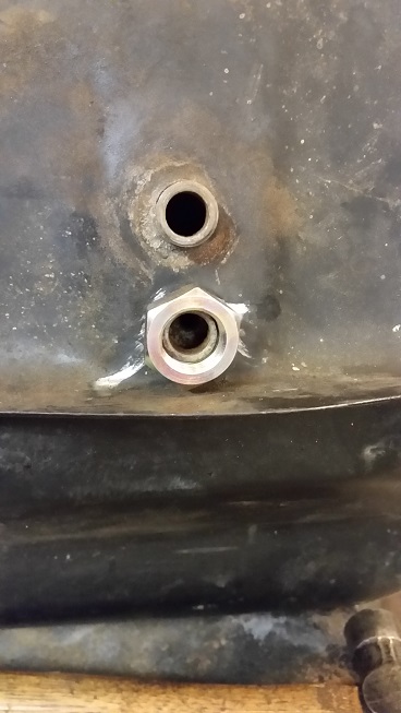

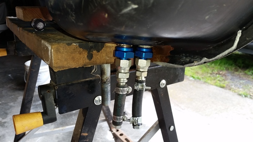

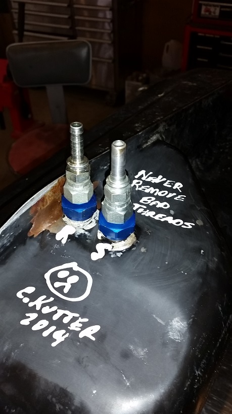

Had I little trouble at hose shop. They don't really deal in the small stuff. But we finally found what I was looking for.
Click to view attachmentWith my bunged up threads they were tough to get started and not go on cross
threaded. But you can see them sitting here with 2 gallons of gas checking for leaks.
Dry as a bone. But I am going to mark the bottom of the tank ....
never remove bad threadsI tested one of them on one of my other tanks. They went on smooth as silk. Nice product.
Note : They seal with an O-ring.
I'd say for cleaning the threads if the tank sealer is your only issue. Clean threads with the nut with the cuts in it. Oil as you go thru the cuts. I turn a 1/4, back up a 1/2. Rinse and repeat until you get to the bottom. I took it off once and cleaned the threads with a wire brush. Then use a new unused nut to tidy up the starter threads.

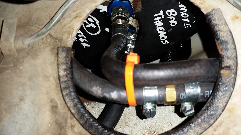

Final couple shots ............
Tank with my notes on it.
Click to view attachmentNew look under the tank ..........

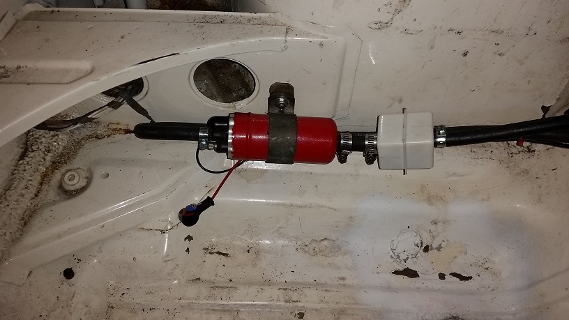

Zip tie is to take a slight kink out of the pressurized lineClick to view attachmentNew fuel pump layout in the trunk
Click to view attachmentSo tank is sitting there with a couple gallons in it checking for static leaks.
If it passes. I'll pressurize it this am.

The fittings? Is that an AN-6 to AN-4 reducer and then a AN-4 reducer? Where did you get those?
cary
Nov 1 2014, 01:47 PM
AN-6.
Ordered from CB Performance. Part was cheap. $7.
Shipping $15. Was here in 3 days.
No reducer. That is AN-6 to 5/16 barb.
