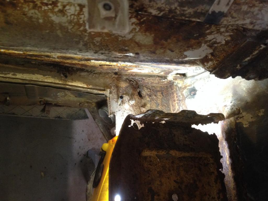

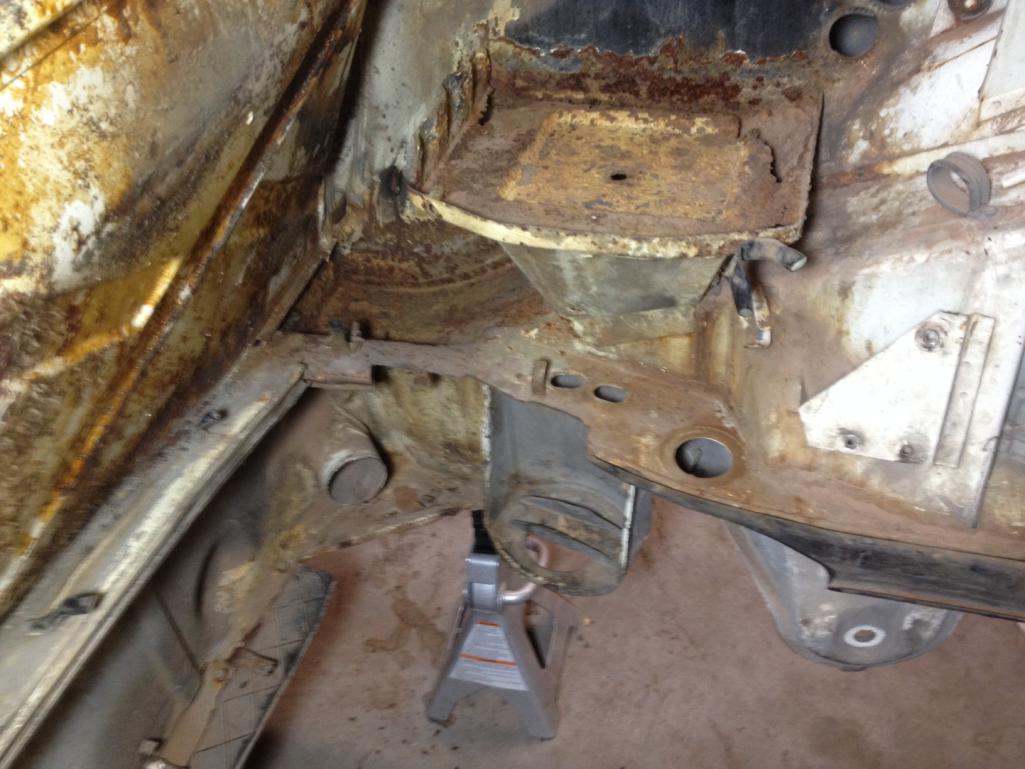

Since I happen to have the engine out for a moment, I can clarify - This photo is taken of the engine compartment from the driver's side, looking right:
You can easily pick out the crusty battery tray. Below it is the inverted square cone of the battery tray support. Just in front of the base of the support (towards the front of the car) you can see a sort of ski slope-looking top of the longitudinal structural member. That's where you need to look. Here it is from above:
You can see how this longitudinal member forms a little pit at the bottom with the attached crossmember. There's a drain hole there, but it is easily blocked with leaves or dirt. You get the triple-whammy of water pooling, dirt to hold the water, and all the battery acid/byproduct shenannegoats. It can be a real mess.
