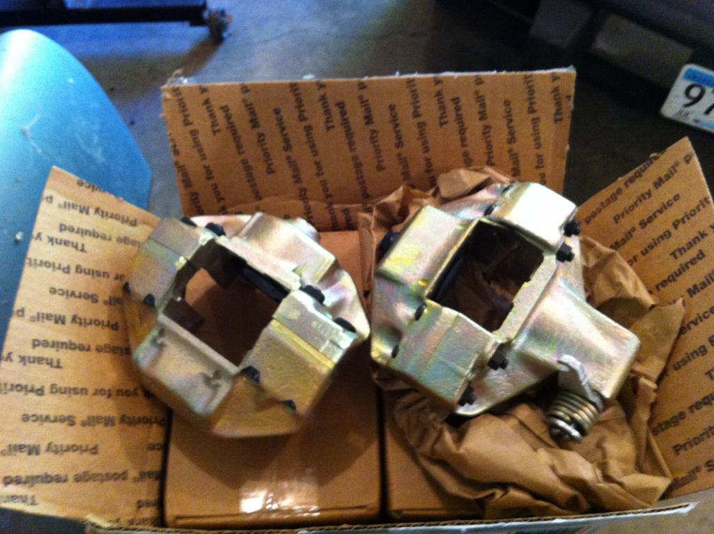

A special WOW! and thank you to PMB performance for fixing me up with these awesome 6 parts! (IMG:style_emoticons/default/pray.gif)
