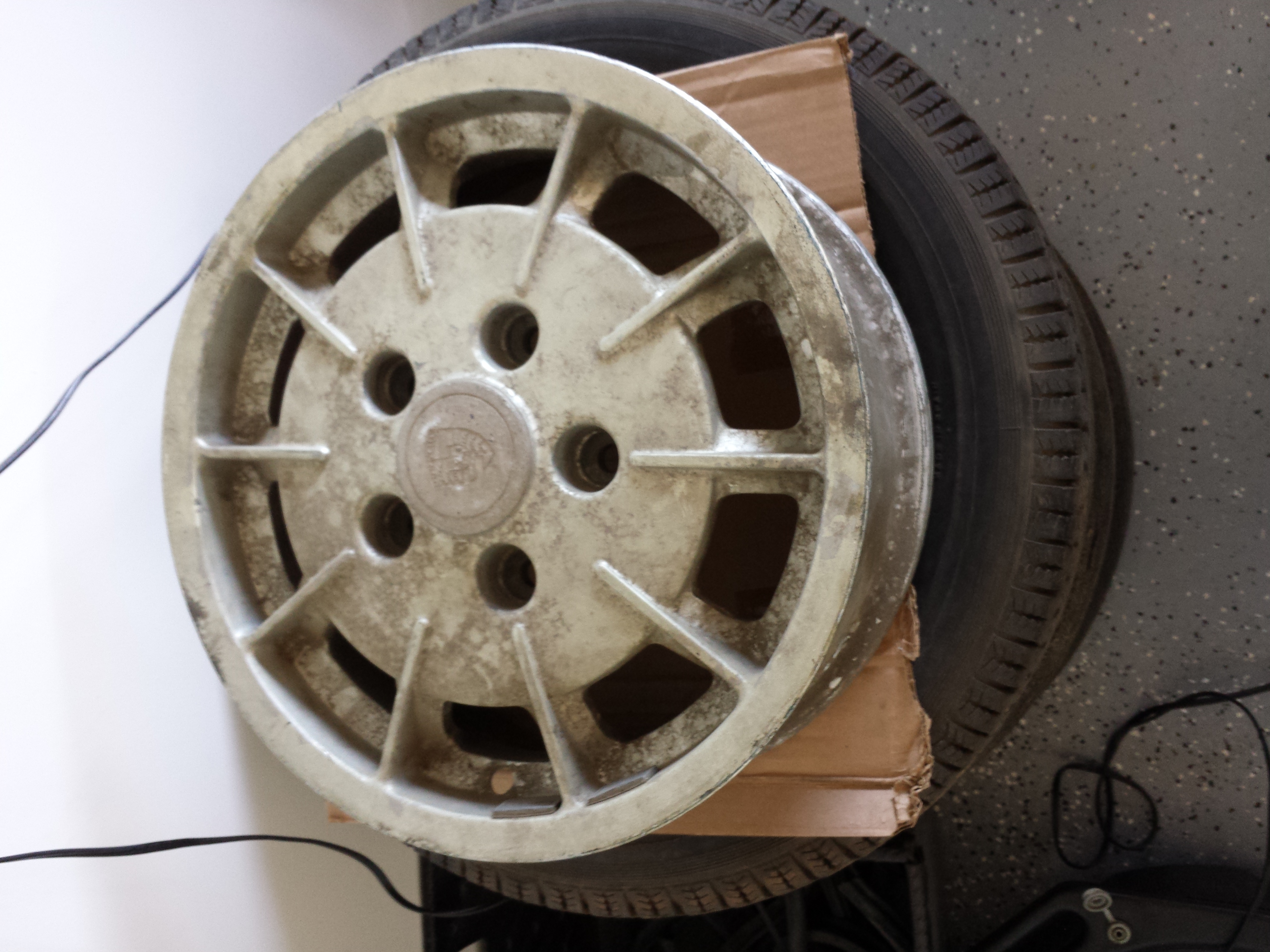

914Sixer
post Jul 4 2014, 05:55 AM
Posts: 9,609
Joined: 17-January 05
From: San Angelo Texas
Member No.: 3,457
Light metal wheels is usually Mahle wheels. 14" Fuchs were the factory wheel but many dealers and individuals swapped them for the 911 15" Fuchs.
C13 is unknown to me.
Maltese Falcon
post Sep 21 2014, 03:21 PM
Posts: 5,453
Joined: 14-September 04
From: Mulholland SoCal
Member No.: 2,755
QUOTE(914Sixer @ Jul 4 2014, 04:55 AM) *
same here, but I'll research c 13 !
I happened on this set of 15" mahles in L.A., and a local guy paid me almost $2,800 for the set of 4. He stockpiles these, sometimes sells on Samba.
At approx 7.5 lbs each, these have to be the lightest Porsche wheels ever.
There are some good (but heavier) aluminum replicas out there if you are in a pinch.

rick 918-S   I got my COA but started a new thread instead of a...   Jul 4 2014, 05:40 AM
914Sixer   Light metal wheels is usually Mahle wheels. 14...   Jul 4 2014, 05:55 AM
Maltese Falcon   Light metal wheels is usually Mahle wheels. 14...   Sep 21 2014, 03:21 PM
rick 918-S   A special WOW! and thank you to PMB performanc...   Sep 20 2014, 10:53 AM
mepstein   My set of mahles weighed 10.2.   Sep 21 2014, 03:25 PM
