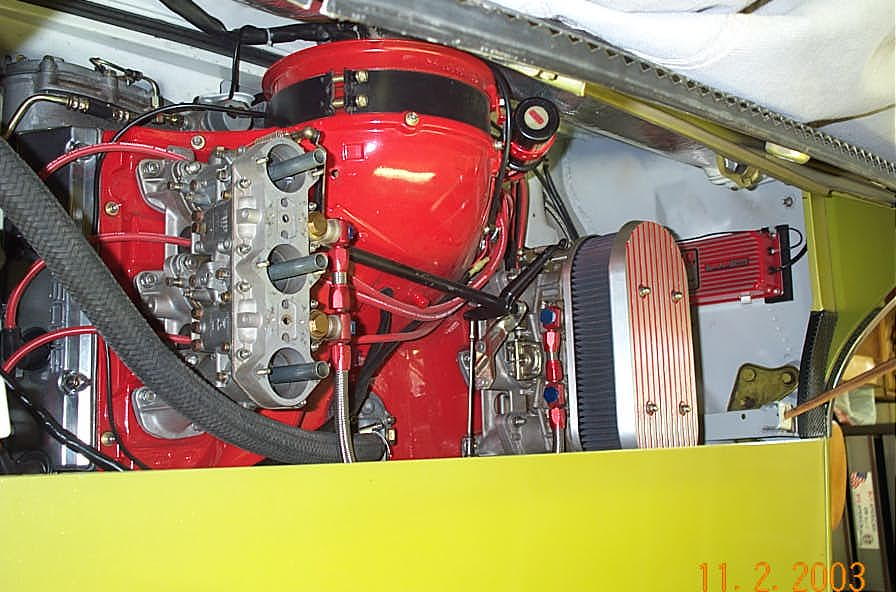

I'll be rebuilding the carbs on my SIX next week.
I wonder if I should do internal baffling while they're open.
What are the benefits to this mod? Perry, Gint, JP, Brad, Lawrence, Sean, Root?
Any other advice ( besides keeping the four ) would be appreciated.

trekkor   The carbs are off the motor and in my shed now. I...   Aug 21 2004, 08:56 PM
J P Stein   I don't say "no". I said I haven't needed...   Aug 21 2004, 10:53 PM
trekkor   JP, I guess what I'm asking is, "Do I need it?...   Aug 21 2004, 11:08 PM

trekkor   Rich, JP, I can see that these Weber dance lesson ...   Aug 22 2004, 09:11 AM
trekkor   O.K.- tonight's the night. I'm going out ...   Aug 23 2004, 07:31 PM
trekkor   ready...   Aug 23 2004, 09:08 PM
trekkor   clean and scattered... one down :) KT   Aug 23 2004, 09:15 PM
Brad Roberts   What size are the venturi's ?? That will tell ...   Aug 23 2004, 09:49 PM
trekkor   30's on the venturi's. I'd be happy w...   Aug 23 2004, 11:18 PM
Brad Roberts   30mm ?? Stock 9146 2.0 was something like 28mm and...   Aug 23 2004, 11:36 PM
trekkor   Brad, 180 on the emulsion tube top jet and 55 idle...   Aug 23 2004, 11:48 PM
trekkor   Carbs are back on the SIX. Started instantly. Hig...   Aug 28 2004, 10:21 PM

trekkor   *THREAD RECOVERY* I'll start by removing the ...   Aug 28 2004, 11:08 PM
Gint   3.5 I think. And IIRC, you are suppposed to shim ...   Aug 28 2004, 11:16 PM

trekkor   Fuel leak is gone now due to the fact that *someon...   Sep 2 2004, 10:22 PM
Gint   Trekkor, Try this. Mid-Engine Views Weber articl...   Sep 3 2004, 08:23 AM
Root_Werks   Good job on the carbs! :D Your venruries a...   Sep 3 2004, 09:39 AM
trekkor   Thanks, Brad and Rich. Now I have the sync and flo...   Sep 22 2004, 06:47 PM
