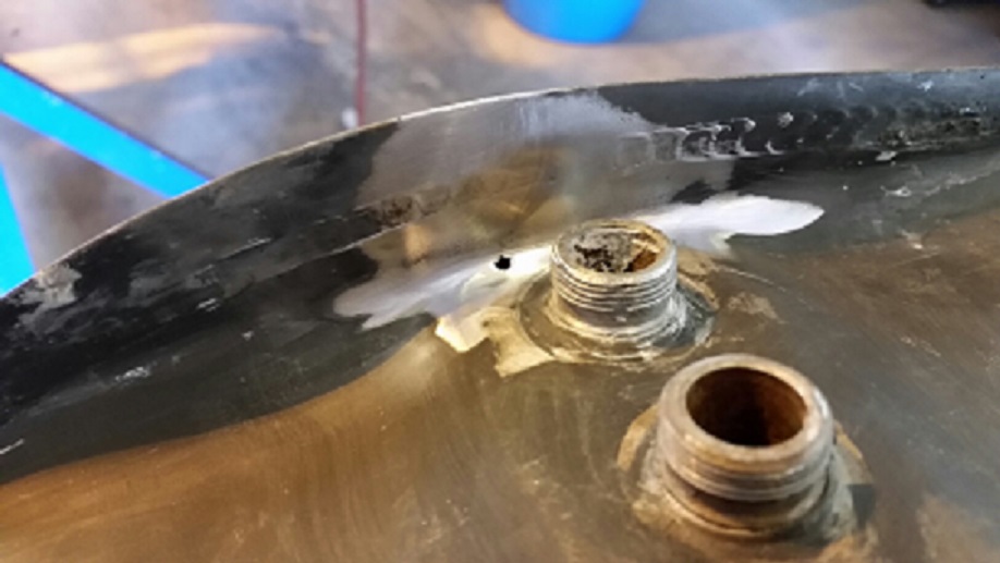

I've been in about the same spot for a couple weeks. I thought my return tube was leaking. Its been sitting with a good application of Teflon thread sealant for a couple weeks. Installed it yesterday and got a big drip of gas in my eye ......Dandy
After closer inspection ............. pin hole in tank
So I Googled fuel tank repair. Lots on cleaning with apple cider vinegar. Lots on don't use JB weld. I'm going to try the Permatex epoxy stuff for a short term fix. Pulled out my other 73 tank, too rusty. It's been out of the car eight years.

mepstein   buy a gallon or 2 of apple cider vinegar. pour in ...   Oct 12 2014, 07:26 AM
cary   I've been in about the same spot for a couple ...   Oct 12 2014, 08:50 AM
mepstein   Vinegar is cheap, works great and no noxious fumes...   Oct 12 2014, 09:41 AM
