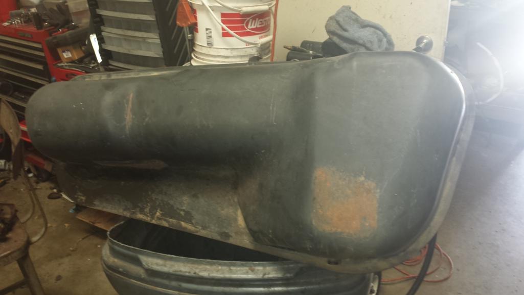

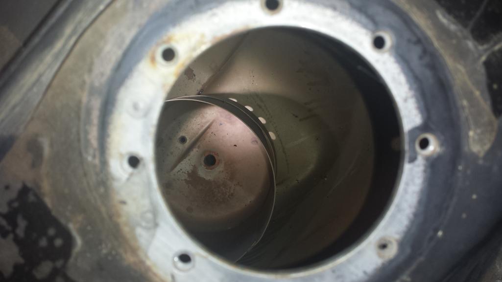

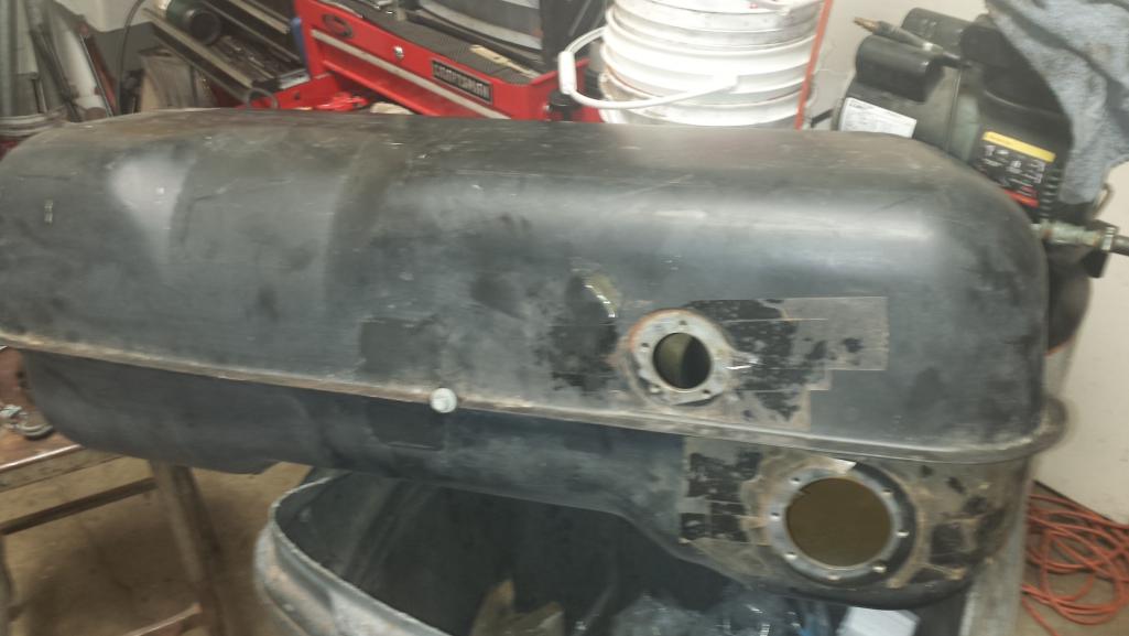

So, I start the process of replacing my fuel pump today (which has been relocated up front by PO). So I got the tank out and it was starting to look pretty "rusty". So I figured I woul attempt to strip it down and repaint it. I have gotten most of the paint stripped off, but how am i going to get some/all of this surface rust off?
Any good radiator shops in San Ramon area I could drop it off to have someone finish it for me this week? Note: the inside of the tank looks very good....as if someone re-did the tank sometime ago.

Mike Bellis   You need to find a powder coating shop. They can b...   Sep 6 2014, 06:51 PM
boxsterfan   You need to find a powder coating shop. They can ...   Sep 6 2014, 06:57 PM
Jeff Bowlsby   There is a shop in hayward...can't recall the ...   Sep 6 2014, 06:55 PM
Harpo   You mentioned that the PO had possibly redid the t...   Sep 6 2014, 06:58 PM
boxsterfan   Electro-Plating Specialties Incorporated 2436 Ame...   Sep 6 2014, 07:04 PM
Mike Bellis   Most powder coating shops have a blaster...   Sep 6 2014, 07:09 PM

boxsterfan   Well, after my CSOB attempt to repaint my tank and...   Oct 11 2014, 10:21 PM

Harpo   I believe that both rotary and racer Chris have fu...   Oct 12 2014, 05:42 AM
bdstone914   I bought a bunch of extra crush washers from rotar...   Oct 12 2014, 06:28 AM
mepstein   buy a gallon or 2 of apple cider vinegar. pour in ...   Oct 12 2014, 07:26 AM
cary   I've been in about the same spot for a couple ...   Oct 12 2014, 08:50 AM
mepstein   Vinegar is cheap, works great and no noxious fumes...   Oct 12 2014, 09:41 AM
