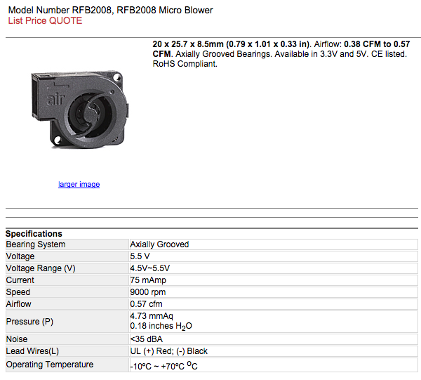

Check this out..... found this Micro fan and has some impressive MBF ratings. I think this would work perfectly as a "Blow" source for the charcoal canister on my Renegade. Trying to make this system stock because we know it works and in my opinion it's the best way to go. Not knocking those that port it out the bottom but not the way I want to go.
Dave

Chris914n6   Later 75s & 76s have a more modern setup. That...   Oct 14 2014, 02:07 PM
Downerman   Yeah 5V...... small, quiet, low CFM and it has a 1...   Oct 15 2014, 10:08 AM
r_towle   Run the little small vent line down the back and o...   Oct 14 2014, 07:38 PM
Chris914n6   I was questioning the 5 volts part. Nothing in the...   Oct 15 2014, 02:29 PM
skeates   Not sure that little guy will move enough air for ...   Oct 15 2014, 04:06 PM
Downerman   I know..... .57 was exactly (or near) what I was w...   Oct 15 2014, 06:34 PM
skeates   I know..... .57 was exactly (or near) what I was ...   Oct 15 2014, 06:58 PM
Downerman   You know this is why I hate email and sometimes po...   Oct 15 2014, 07:10 PM
skeates   I apologize for coming across that way but once a...   Oct 15 2014, 07:39 PM
