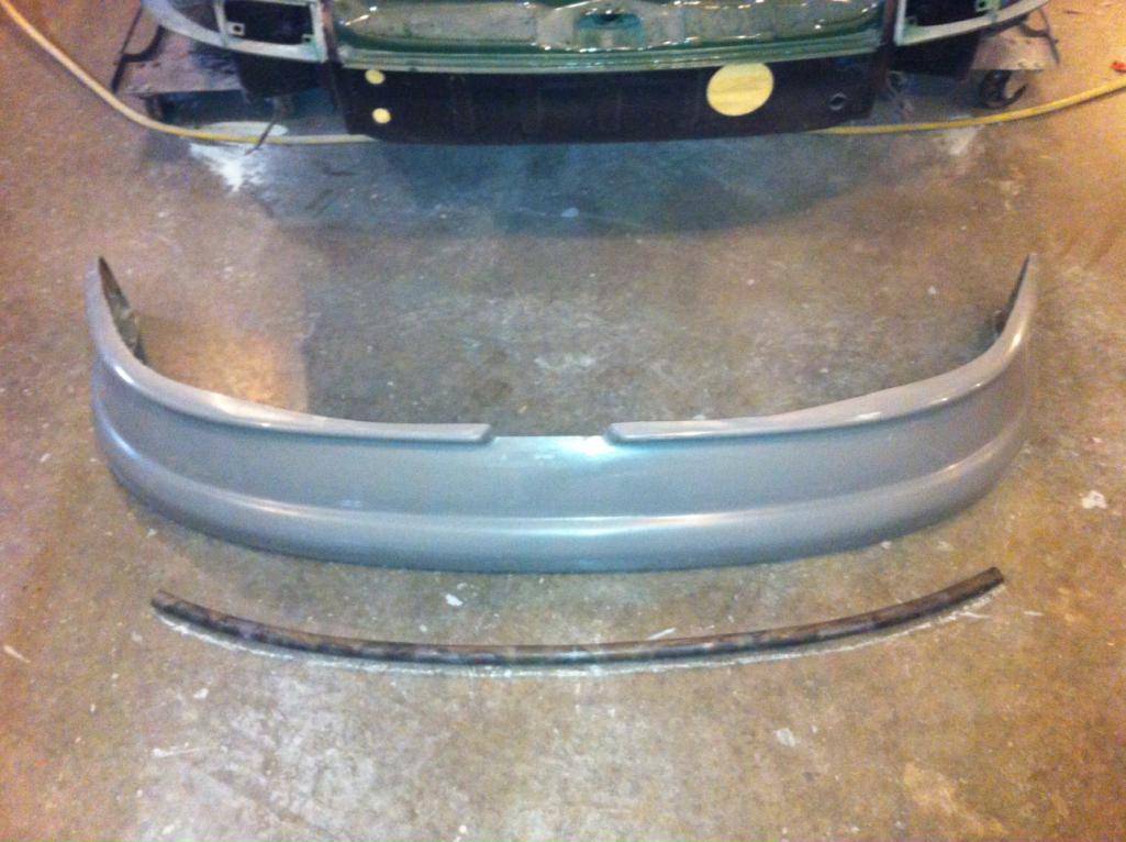

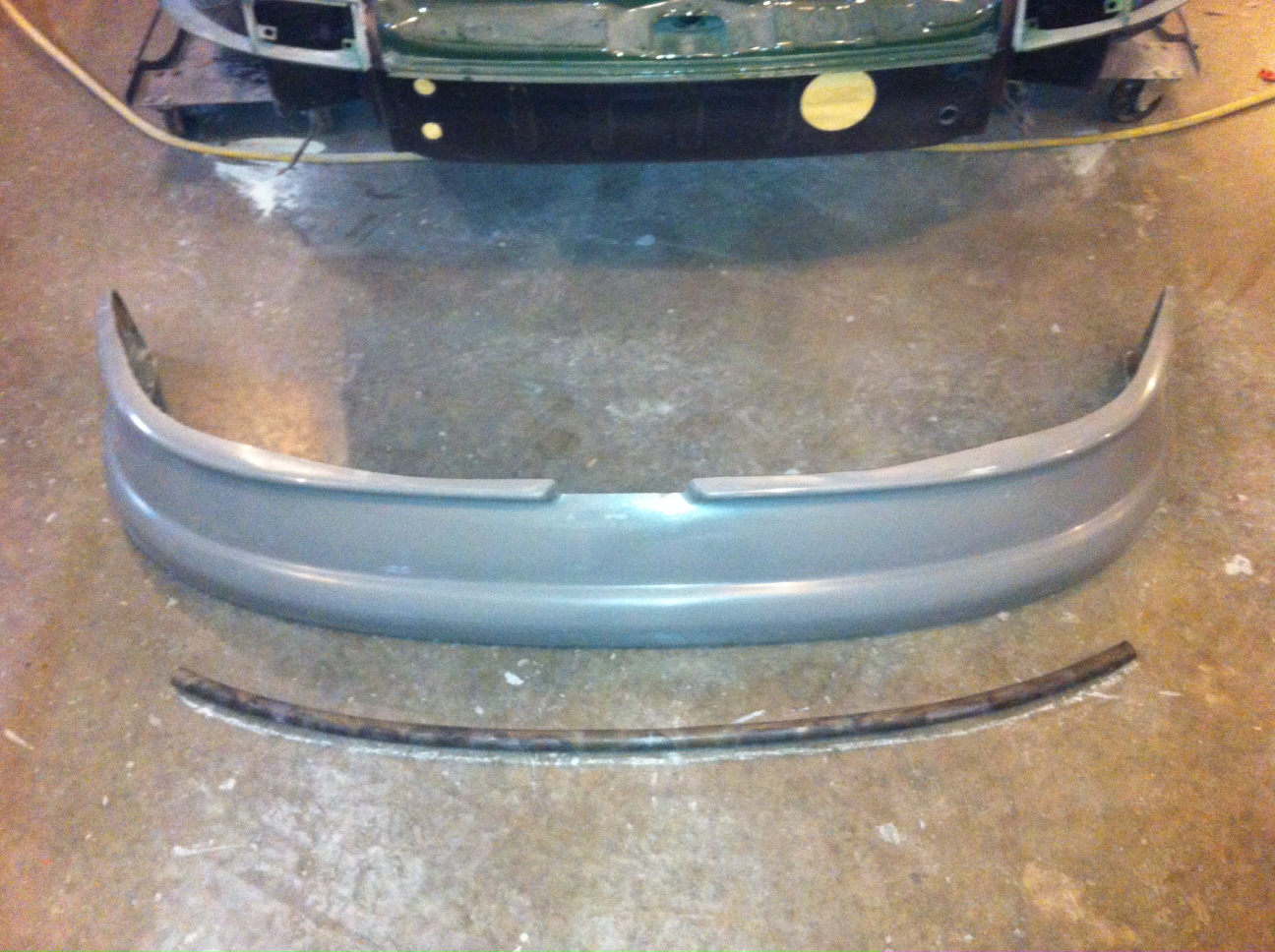

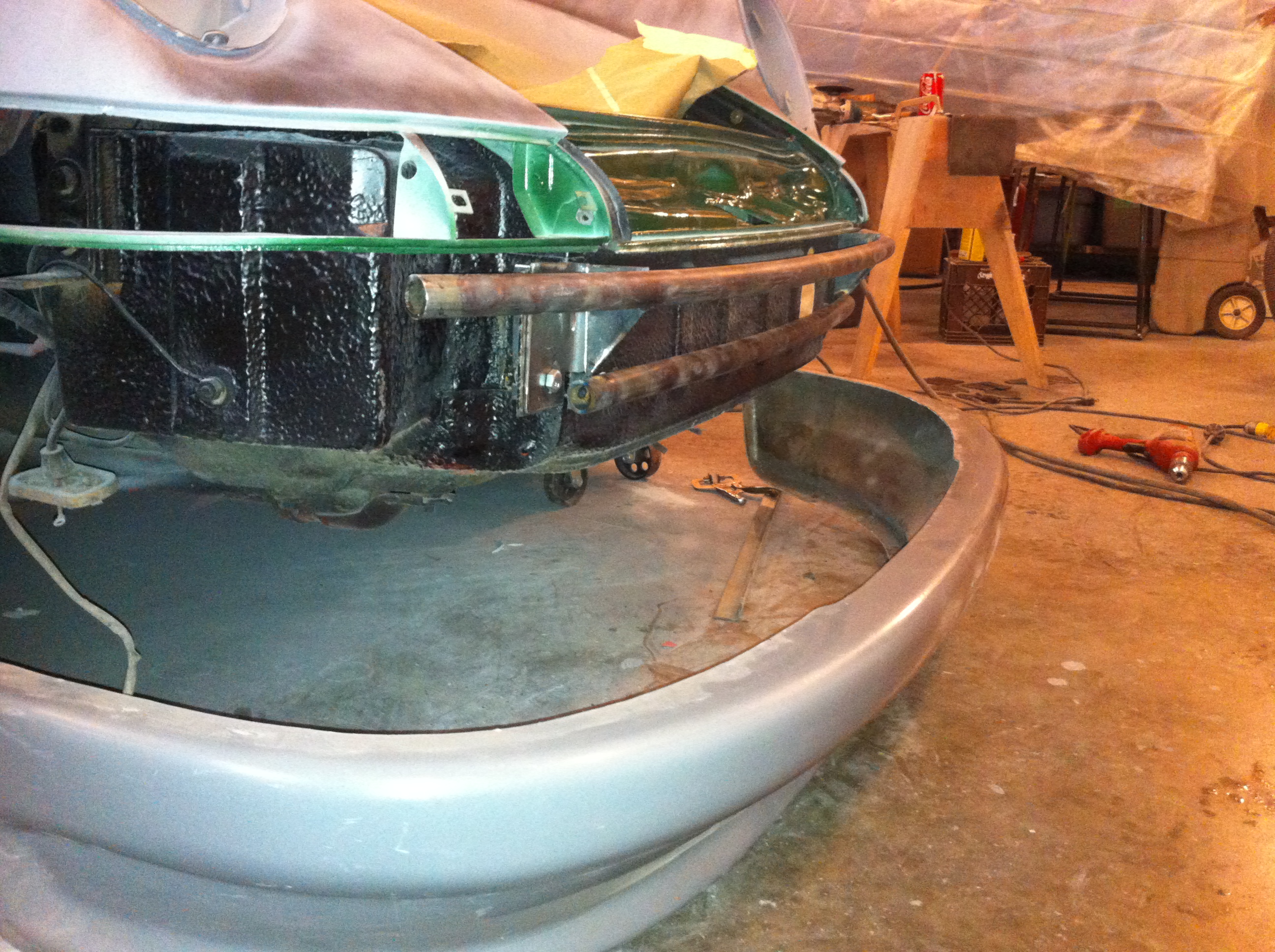

I was looking through some photos and though you guys may be interested in the bumper install I did for the 911. The owner wanted a glass bumper. It came with a couple flimsy strips of fiber glass to mount it. Well That was not going to do. I built a inner bumper out of 4130 tubing. I heated and bent the tubing to match the curve of the bumper, made some mounting brackets and bonded it to the back of the glass.
