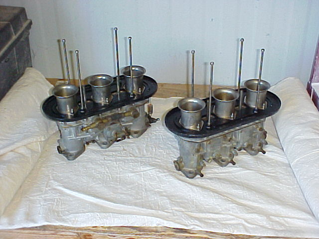

I'll be rebuilding the carbs on my SIX next week.
I wonder if I should do internal baffling while they're open.
What are the benefits to this mod? Perry, Gint, JP, Brad, Lawrence, Sean, Root?
Any other advice ( besides keeping the four ) would be appreciated.

trekkor   The carbs are off the motor and in my shed now. I...   Aug 21 2004, 08:56 PM

trekkor   O.K.- tonight's the night. I'm going out ...   Aug 23 2004, 07:31 PM
trekkor   ready...   Aug 23 2004, 09:08 PM
trekkor   clean and scattered... one down :) KT   Aug 23 2004, 09:15 PM
Brad Roberts   What size are the venturi's ?? That will tell ...   Aug 23 2004, 09:49 PM
trekkor   30's on the venturi's. I'd be happy w...   Aug 23 2004, 11:18 PM
Brad Roberts   30mm ?? Stock 9146 2.0 was something like 28mm and...   Aug 23 2004, 11:36 PM
trekkor   Brad, 180 on the emulsion tube top jet and 55 idle...   Aug 23 2004, 11:48 PM
trekkor   Carbs are back on the SIX. Started instantly. Hig...   Aug 28 2004, 10:21 PM
