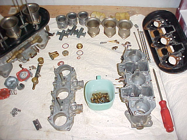

I'll be rebuilding the carbs on my SIX next week.
I wonder if I should do internal baffling while they're open.
What are the benefits to this mod? Perry, Gint, JP, Brad, Lawrence, Sean, Root?
Any other advice ( besides keeping the four ) would be appreciated.

clean and scattered...
one down (IMG:style_emoticons/default/smile.gif)

trekkor   O.K.- tonight's the night. I'm going out ...   Aug 23 2004, 07:31 PM
trekkor   ready...   Aug 23 2004, 09:08 PM
trekkor   clean and scattered... one down :) KT   Aug 23 2004, 09:15 PM
