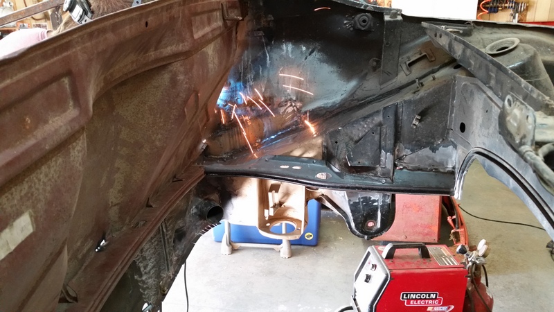

After finishing my rotisserie I am finally getting back to actual car work (started in 03). I am redoing what I did in the past (made a mess of it) and hopefully moving on from there. Doug has is helping me with the restoration, so hopefully we can make some actual progress. The entire passenger side of my car is pretty rotten so we have our work cut out for us. I got the good part of the long cut out so when Doug gets here maybe we can start filling in the gaps.
In this pic I have cut out the outside long bit.

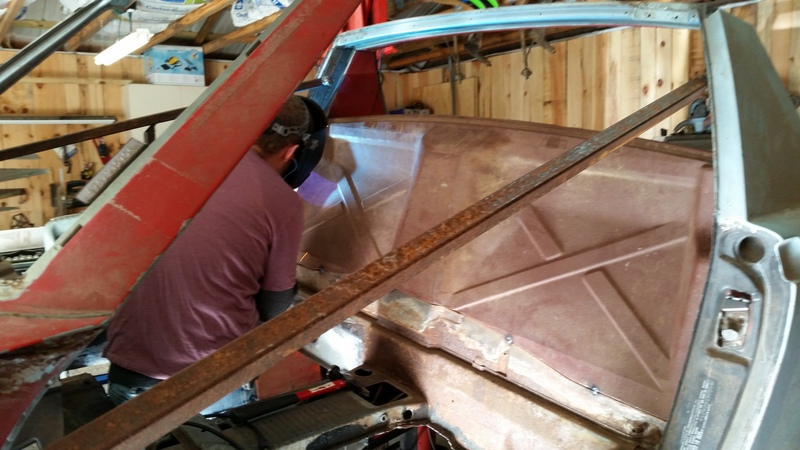

It was a good day today at the Lamb house hold. Doug Leehr came over again and we made some major progress. We got the engine shelf situated and the main firewall welded in! After Doug left I pulled the engine shelf, primed and drilled it and started to weld it back in. The engine bay is seriously starting to look put together.
This puts me back on track. With the floor next I have lots to keep me busy.
Thanks again Doug!
