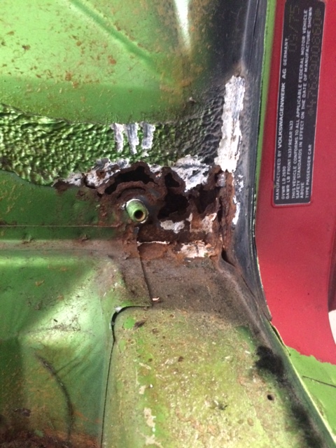

I've made a start on removing the hacked up loom & vacuuming all the loose rust out. Its better than expected (as I bought the car only from pictures)
it needs;
new hell holes
back of floorpan & bottom of firewall
boot

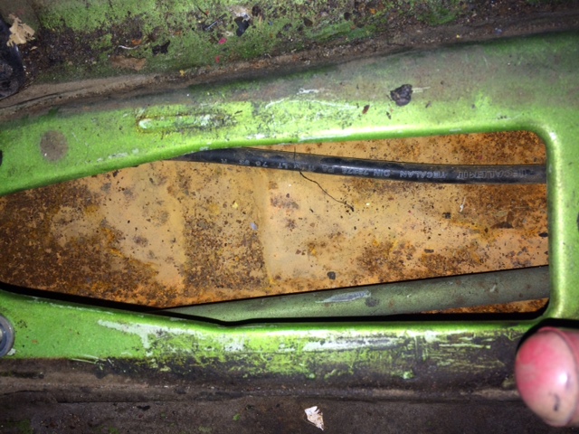

and that's about it - the rest of it looks (at this stage) like only surface rust - the suspension consoles are solid as is the majority of the front boot - again, only surface rust there ...

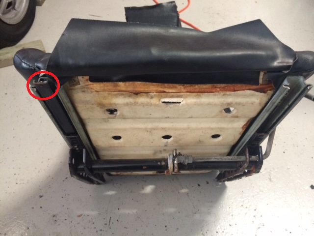

question though - how do I remove the left hand seat ? the lever at the side does nothing - possibly broken ? and there is no handle at the front to slide the seat forwards to get at the rear bolts ... stumped on this one ...

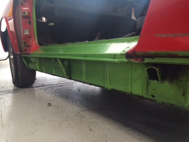

Door came off - easy, but geez its heavy - I can see a fibreglass skin in its very near future !

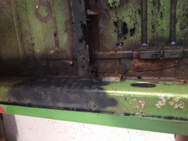

Pulled off sill cover expecting a fair amount of rust given how mud mud & stone fell out when I pulled the cover off - but 10 minutes cleaning revealed an extremely clean sill/rocker ! couple of small spots of surface rust but otherwise extremely good.

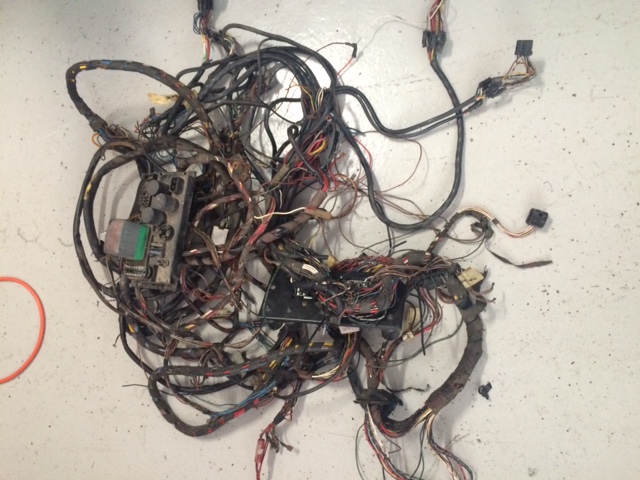

Finished removing the loom - there is about 3kg of surplus in that I think (IMG:style_emoticons/default/wink.gif)
removed the seat, the pic shows the seat with the broken off tab - I was stuffing around for ages with this poking bits of metal under the seat - all I needed to do was lift the tab up - I think it should have a longer tab on it that's broken off ...

the left land side scallop in the rocker has been well covered - couldn't see any cracks but will clean it back to bare metal & get a better look.
