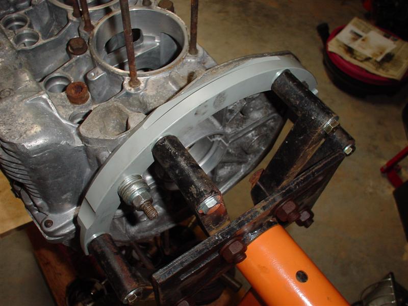

This may have already been covered, but I haven't had any luck figuring my problem out. I've got my engine pulled, tranny separated and the engine is on my ATV jack. I just bought an engine stand and now I can't figure out how to mount the engine to it (IMG:style_emoticons/default/headbang.gif) The ATV jack won't raise high enough to get all 4 mounting points to line up. And, the base of the stand won't allow the stand to get close enough to the engine, due to the base of the jack.
Anyone have any tricks they could share?

You could take the yoke off the stand and over to the engine and bolt it to the engine and with a strong friend, put it in the stand.
or
You could buy the engine adapter offered by MainelyCustomByDesign (no affiliation) that will allow the use of your engine stand and mount a VW or Porsche engine. One good thing about using the adapter is that it will allow mounting the flywheel while the engine is mounted.

stugray   Mount the yoke to the engine first. Leave the engi...   Oct 29 2014, 10:40 AM

914Sixer   I put a sling around the engine. Install engine ...   Oct 29 2014, 04:22 PM
maf914   I Throw a chain around tree limb, attach wench, a...   Oct 30 2014, 05:46 AM
CatDaddy60   I used to pick up the engine after bolting the yol...   Oct 29 2014, 04:48 PM
