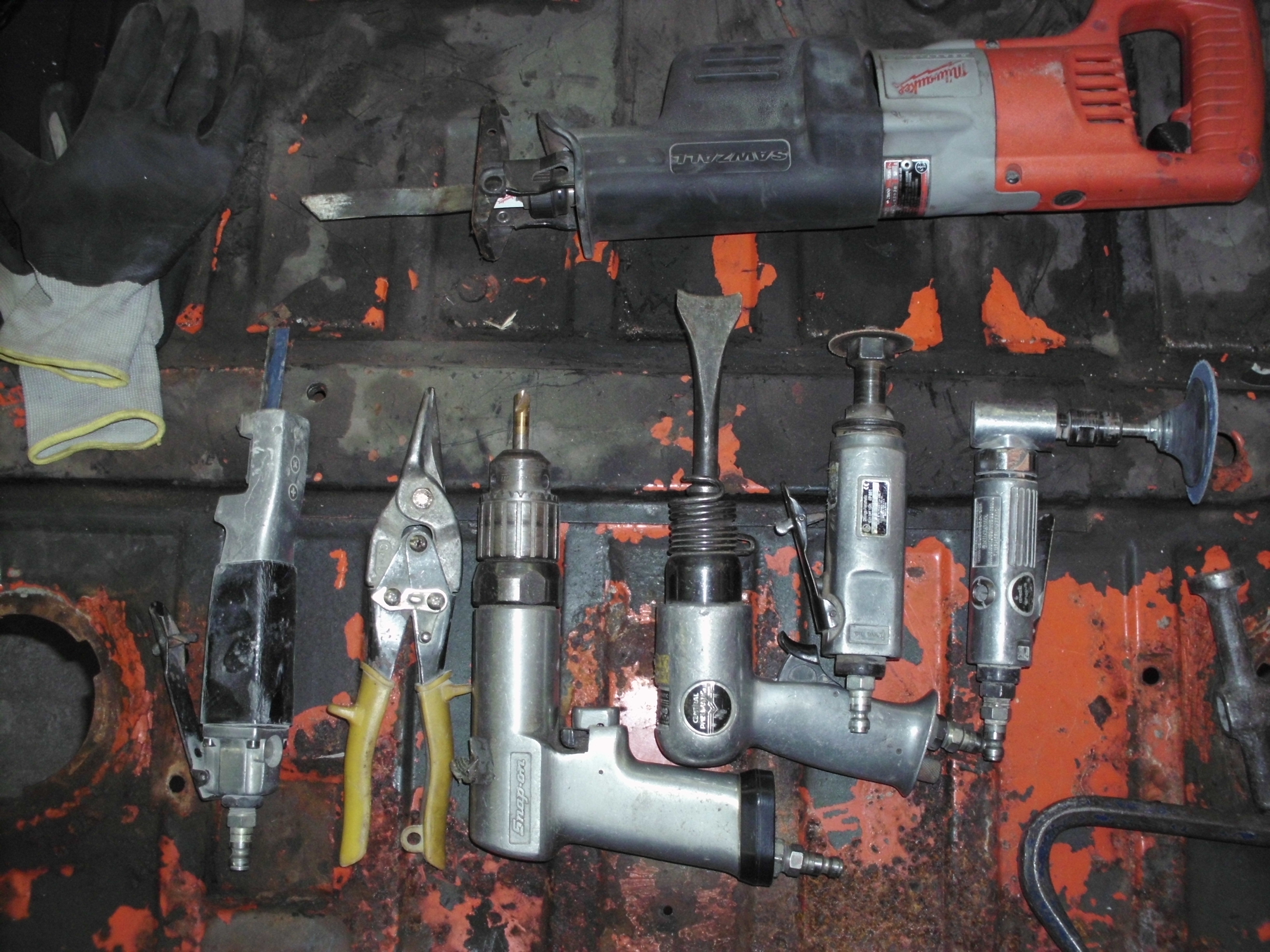

What did you use to remove the panels? What ever it was it seemed to go well.
914350
post Oct 29 2014, 08:09 PM
Posts: 548
Joined: 21-April 14
From: Torrance Ca.
Member No.: 17,275
QUOTE(trojanhorsepower @ Oct 26 2014, 05:09 AM) *
There's many different tools that are used, I use a sawzall/Reciprocating saw (large and small) and a cut off wheel to cut the panel back to the edges then a spot weld drill bit to help with separating the spot welds and even a air chisel at some points but being carful not to damage the lip/edge that the new panel will attach to. there's lots of different ways to go about it, sometimes the welds just snap loose as you twist the metal away.
