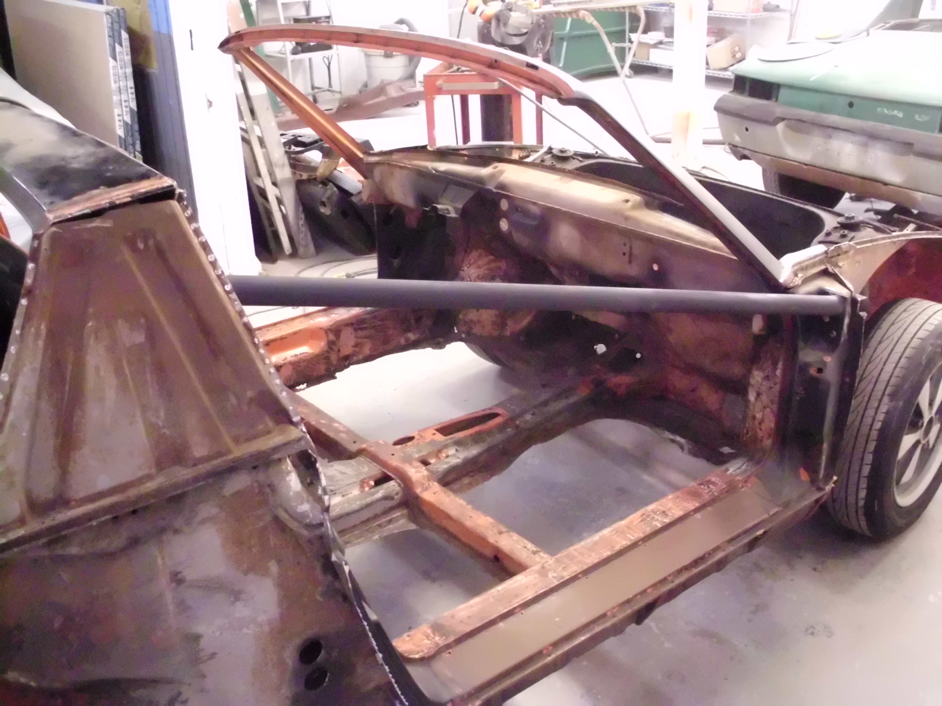

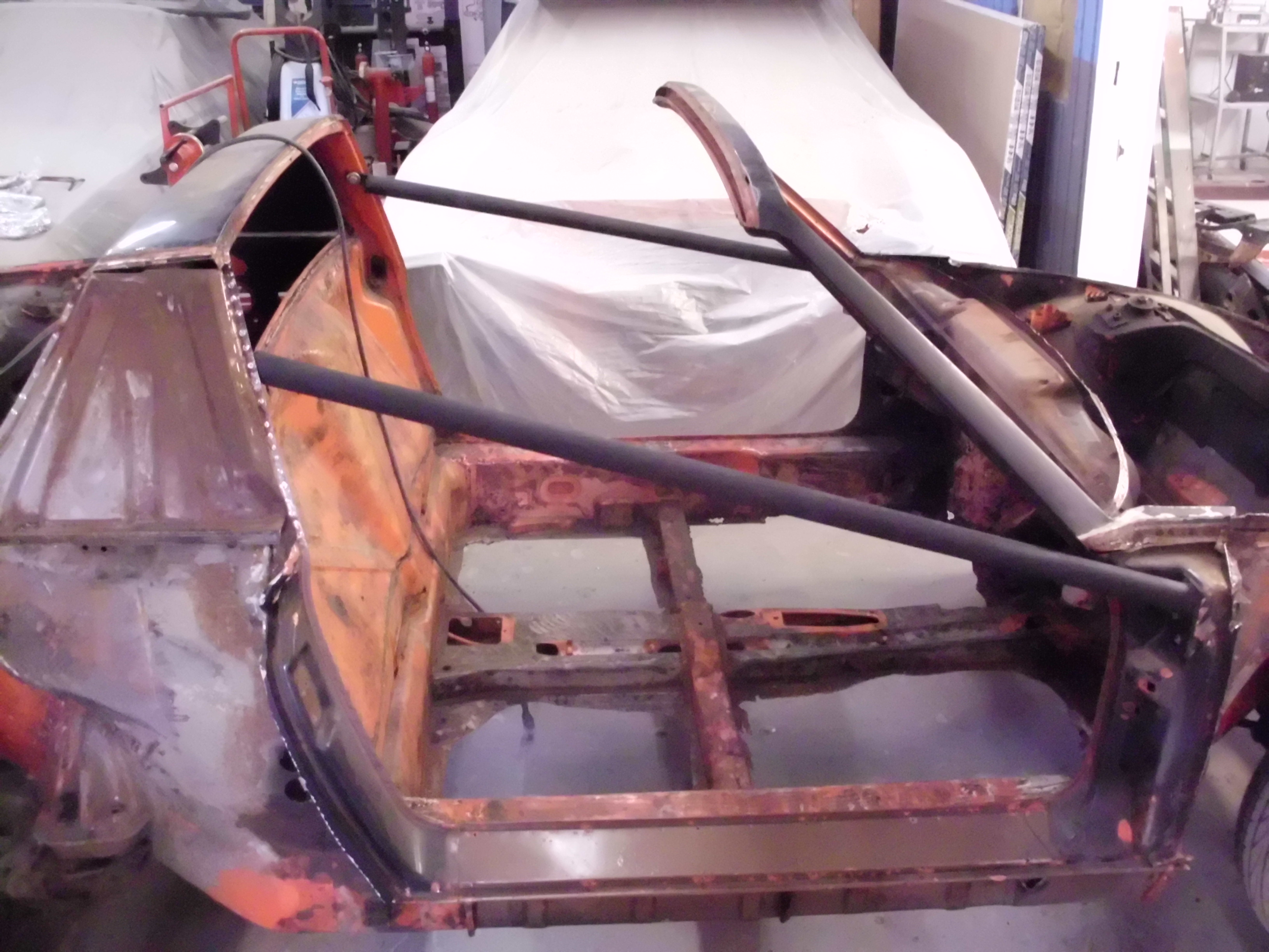

The car is headed to Media blasting this Friday, support bars installed so the body doesn't flex.
